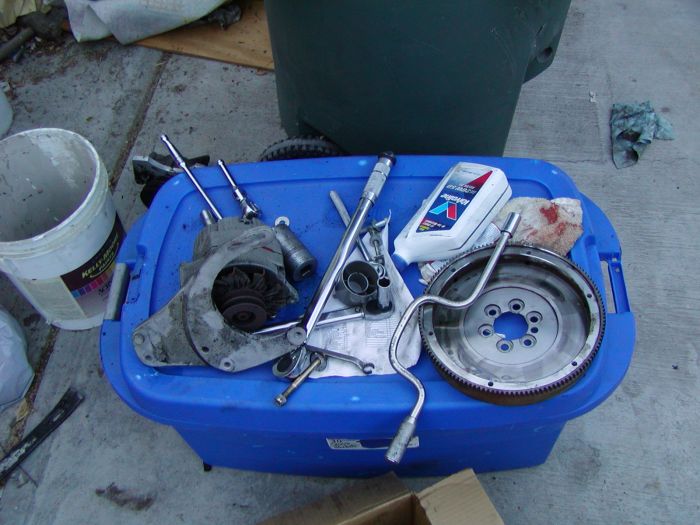

Alternator mount, and "custom" alternator... I'll just use my basically new alternator from pick and pull, spins better.
In the background is the smog pump... Can you guess what Im going to do with that?..
save it incase the Man says that all cars have to be smogged.
