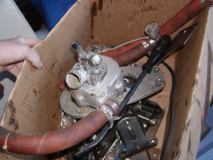

Box of parts.. Reverse fittings.. some bolts, whatnot.. thermostat stuff, and a water pump!!!!
