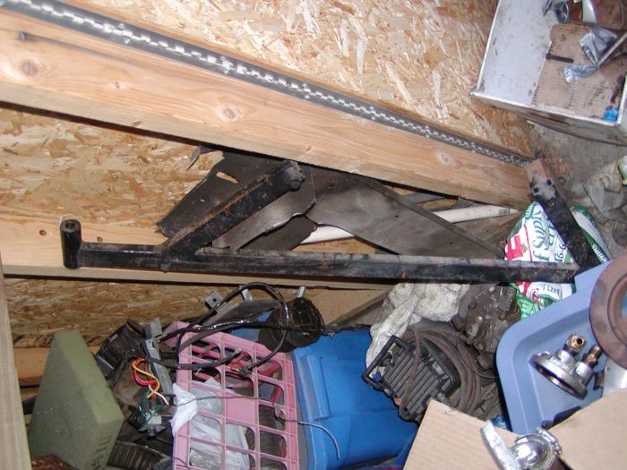

And last, but appropriately not least, is the engine mount bar..
Which I like.. Much better than the clamp two U clamps on with some square tubing, and go...

Andyrew   And last, but appropriately not least, is the engi...   Aug 3 2004, 09:42 PM
