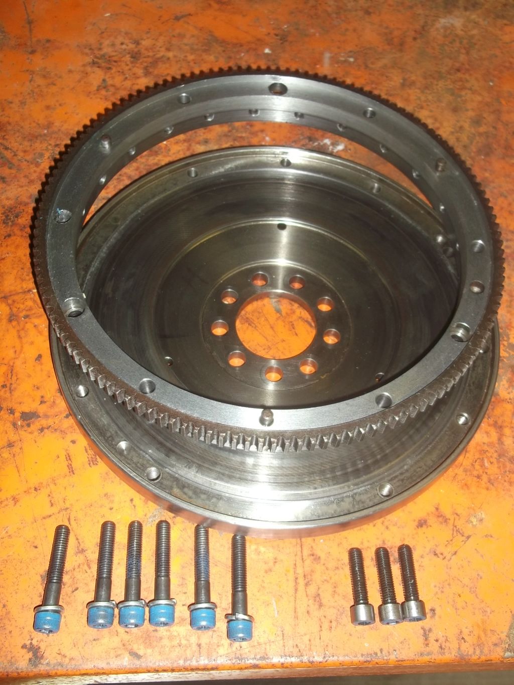

The ring was made from a type 1 VW beetle flywheel.
The flywheel was lightened a bit, the holes were really just added for drainage/dust. Stock /4 flys have 6 holes, so I went a bit overboard, it "may" have taken a hair of weight off. Before I drilled the holes the ring and flywheel weighed just under 14lbs, about the same as a stock /4.
The pressure plate is a CSP HD performance type 4 vanagon 228mm.
No I will not make you one, not worth it to me to sell these. the VW and Porsche flywheels are hard as hell, this was tough going.

McMark   Can you weigh the flywheel w/ adapter as well as t...   Feb 8 2014, 03:38 PM
Mark Henry   Can you weigh the flywheel w/ adapter as well as ...   Feb 10 2014, 11:12 AM
