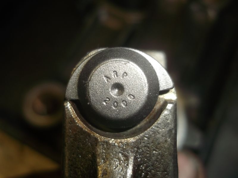

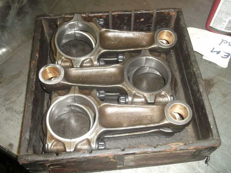

Rebult rods with ARP bolts
Aaaahhhhh....reaming and honing.... (IMG:style_emoticons/default/drooley.gif)
