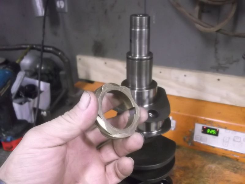

Last thing for today is I swapped out the dizzy drive gear.
A 3.0 has a counter clockwise dizzy, I changed the gear so that I can use a clockwise dizzy.

PanelBilly   Why reverse the gear on the dizzy?   Feb 10 2014, 04:41 PM
Mark Henry   Why reverse the gear on the dizzy? Not just a ma...   Feb 10 2014, 10:31 PM
