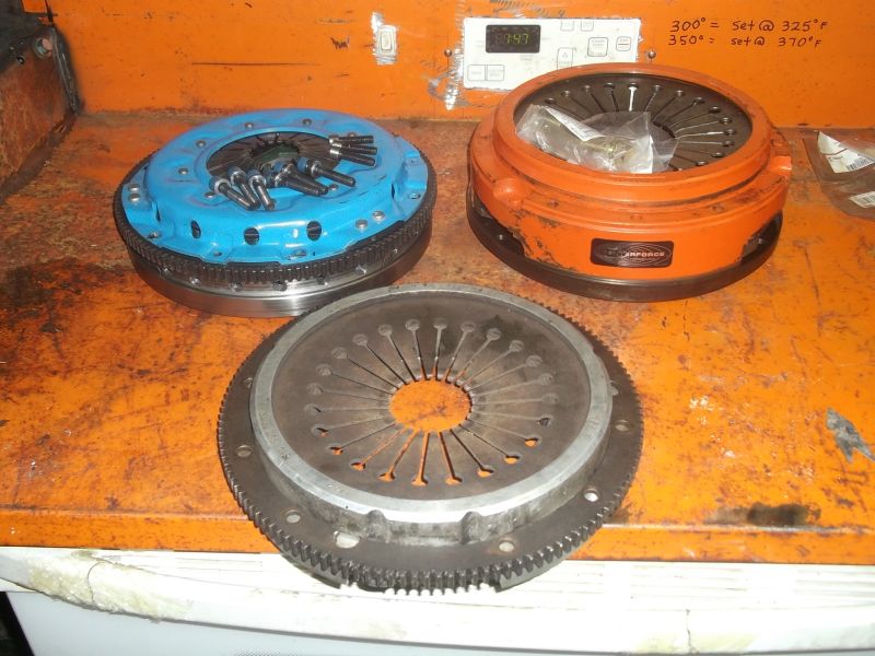

Can you weigh the flywheel w/ adapter as well as the whole flywheel clutch package? I'm interested in comparing a few as time goes on.

QUOTE(McMark @ Feb 8 2014, 04:38 PM) *
My setup on the top left
Flywheel 225mm 9.5 Lbs
Adapter ring 4.4 Lbs
Pressure plate 11.1 Lbs
Total 25 Lbs
Comparison on the top right, 930 245mm flywheel with Centerforce clutch package is 35.5 Lbs
On the lower center is the 1971 aluminum pressure plate at 7.5 Lbs it is a light weight with a stock PP i'm guessing about 20 Lbs total.
Note I have lightened my flywheel, but I didn't weigh it before I cut the outer edge off...I'm guessing stock weight at about 12 Lbs, but I could be wrong.

McMark   Cool! My aluminum flywheel is about 3 lbs and...   Feb 10 2014, 03:47 PM
Mark Henry   Cool! My aluminum flywheel is about 3 lbs an...   Feb 10 2014, 04:06 PM
