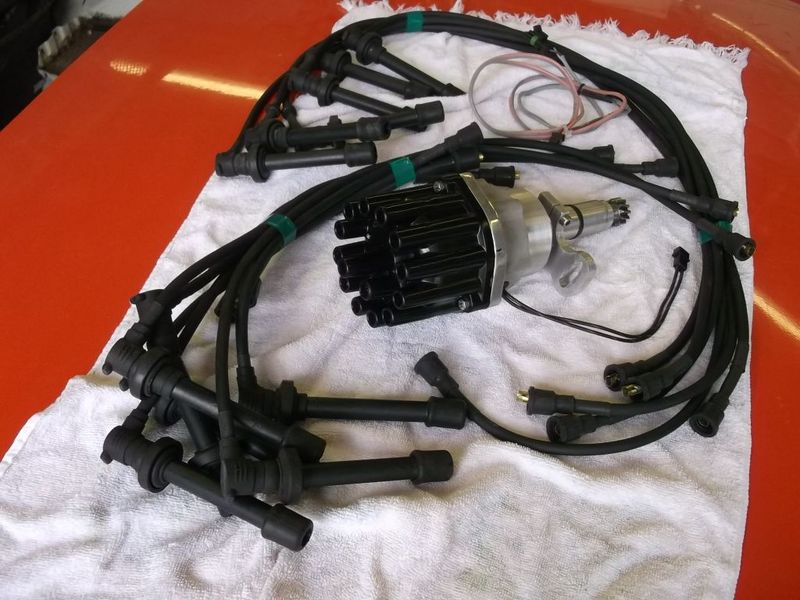

Why reverse the gear on the dizzy?
Mark Henry
post Feb 10 2014, 10:31 PM
that's what I do!
Posts: 20,065
Joined: 27-December 02
From: Port Hope, Ontario
Member No.: 26
QUOTE(PanelBilly @ Feb 10 2014, 05:41 PM) *
Not just a matter of flipping it you have to use a different gear. The 3.0 uses a counter clockwise rotating dizzy the one I'm using rotates clockwise.
My dizzy for this project (IMG:style_emoticons/default/shades.gif)
(IMG:http://www.914world.com/bbs2/uploads_offsite/forums.pelicanparts.com-26-1392093080.1.jpg)

PanelBilly   Why reverse the gear on the dizzy?   Feb 10 2014, 04:41 PM
Mark Henry   Why reverse the gear on the dizzy? Not just a ma...   Feb 10 2014, 10:31 PM
