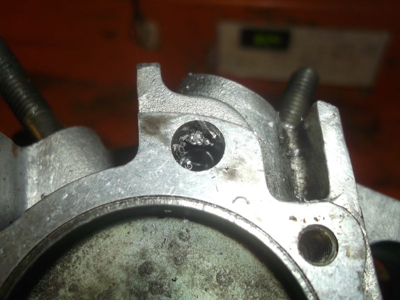

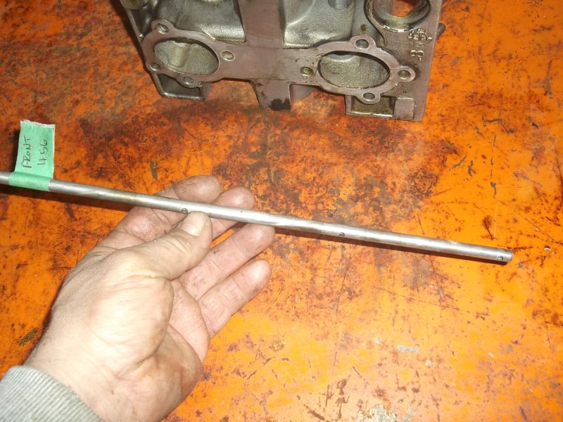

First I pull the factory plugs and then the spray bars (tubes) come out fairly easy. Not shown is the rear line plug actually has a point on it and this is what holds the spray bar in place, not the plugs.

Mark Henry   Got to keep thinks rolling Next job is the cam to...   Feb 11 2014, 10:13 PM
Mark Henry   First I pull the factory plugs and then the spray ...   Feb 11 2014, 10:17 PM
Mark Henry   The cam towers are now a little cleaner, this clea...   Feb 11 2014, 10:21 PM

Mark Henry   Working a bit slow today, but stiff upper lip got ...   Feb 12 2014, 03:57 PM
Mark Henry   The plug and the fresh tapped hole. This is how it...   Feb 12 2014, 04:01 PM
Mark Henry   While doing this it's a good time to chase the...   Feb 12 2014, 04:06 PM
Mark Henry   Now....you're asking yourself why the hell is ...   Feb 12 2014, 04:41 PM
Mark Henry   So I've been using Dr Evils favorite cleaner L...   Feb 12 2014, 04:46 PM
