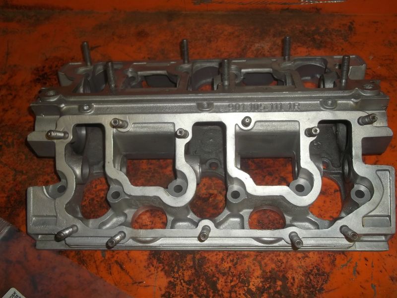

The cam towers are now a little cleaner, this cleaning took quite a while. I have see if I can find a small caliber gun brush tomorrow for the spray bars.
Towers to be continued...same bat time.... same bat channel...

Mark Henry   Got to keep thinks rolling Next job is the cam to...   Feb 11 2014, 10:13 PM
Mark Henry   First I pull the factory plugs and then the spray ...   Feb 11 2014, 10:17 PM
Mark Henry   The cam towers are now a little cleaner, this clea...   Feb 11 2014, 10:21 PM
