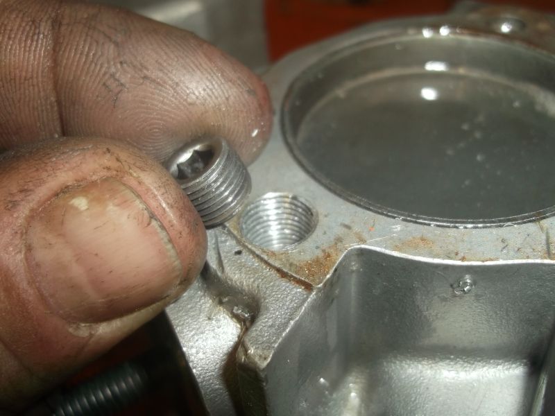

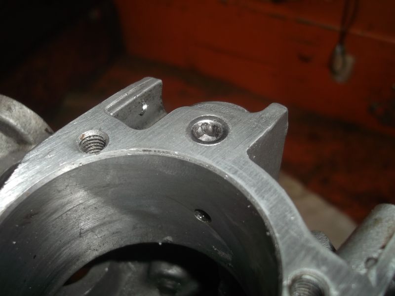

The plug and the fresh tapped hole.
This is how it must sit just below the surface when done.

Mark Henry   Working a bit slow today, but stiff upper lip got ...   Feb 12 2014, 03:57 PM
Mark Henry   The plug and the fresh tapped hole. This is how it...   Feb 12 2014, 04:01 PM
Mark Henry   While doing this it's a good time to chase the...   Feb 12 2014, 04:06 PM
