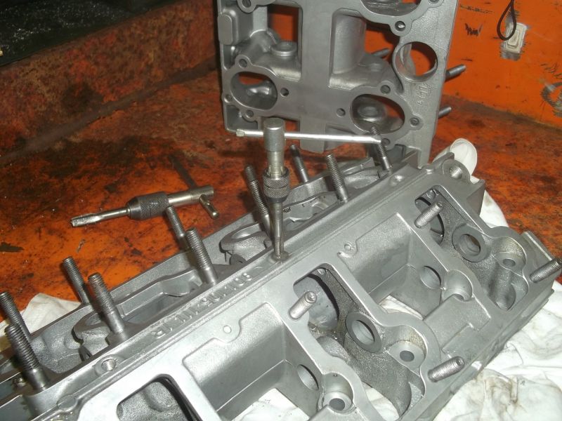

Mark Henry   First the foundation of my build, a 1979 3.0 case,...   Feb 5 2014, 04:41 PM
Mark Henry   A job I just tackled was loctite epoxy on all the ...   Feb 5 2014, 04:51 PM

Mark Henry   Working a bit slow today, but stiff upper lip got ...   Feb 12 2014, 03:57 PM
Mark Henry   The plug and the fresh tapped hole. This is how it...   Feb 12 2014, 04:01 PM
Mark Henry   While doing this it's a good time to chase the...   Feb 12 2014, 04:06 PM
