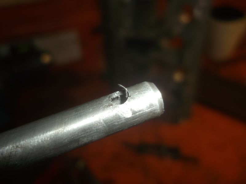

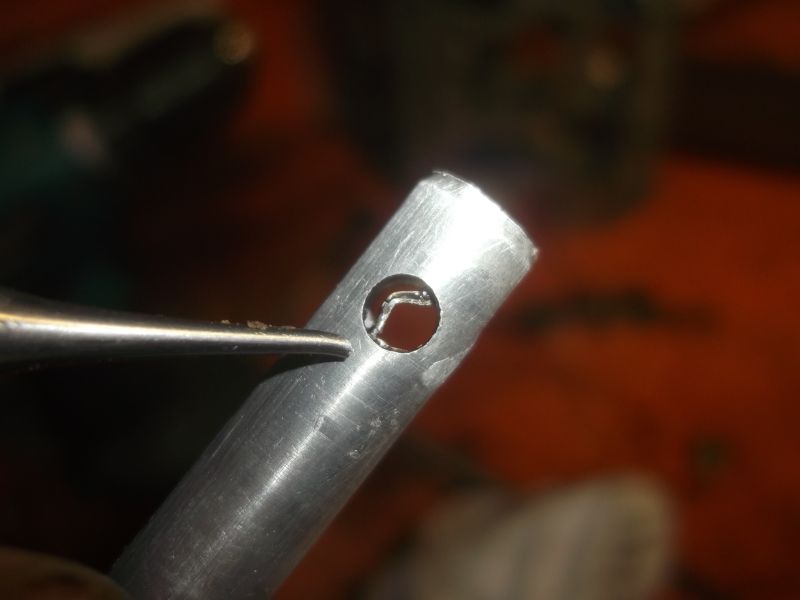

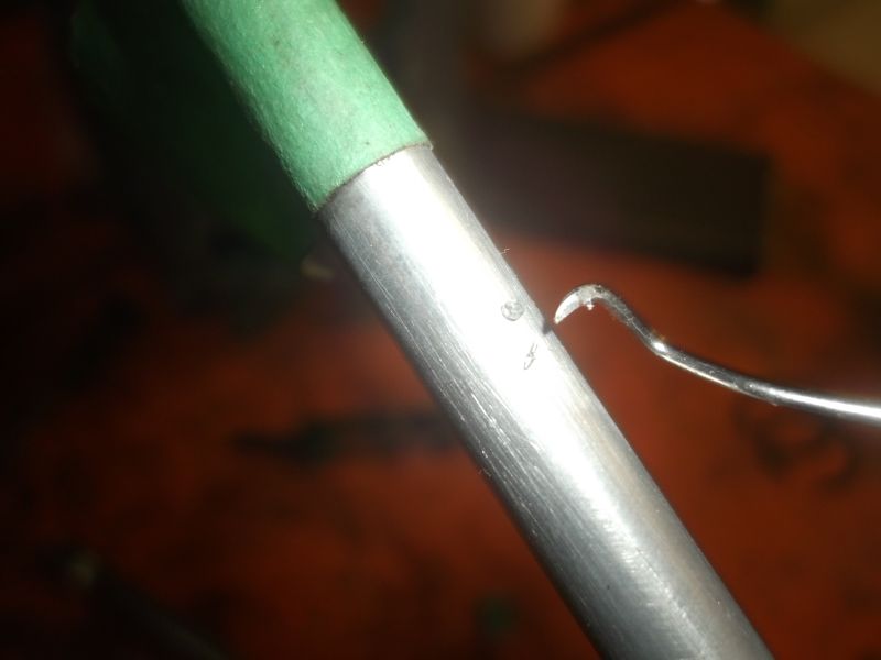

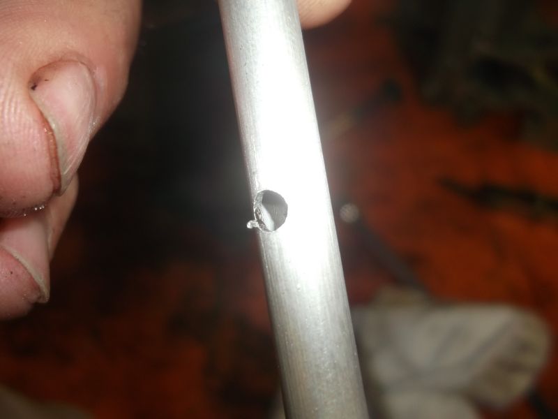

Now....you're asking yourself why the hell is he doing all this work? Just to make the cam towers look pretty??
This is why, look at these burrs in the holes of the spray bars! Maybe they won't come off...maybe they will...do you feel lucky?
