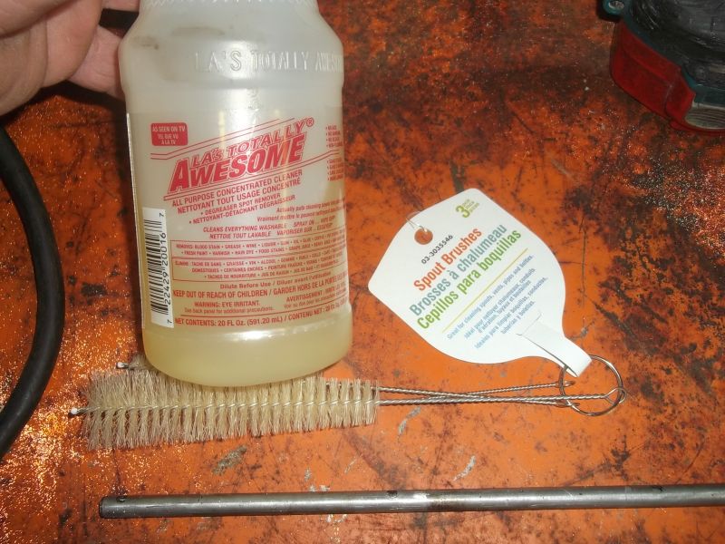

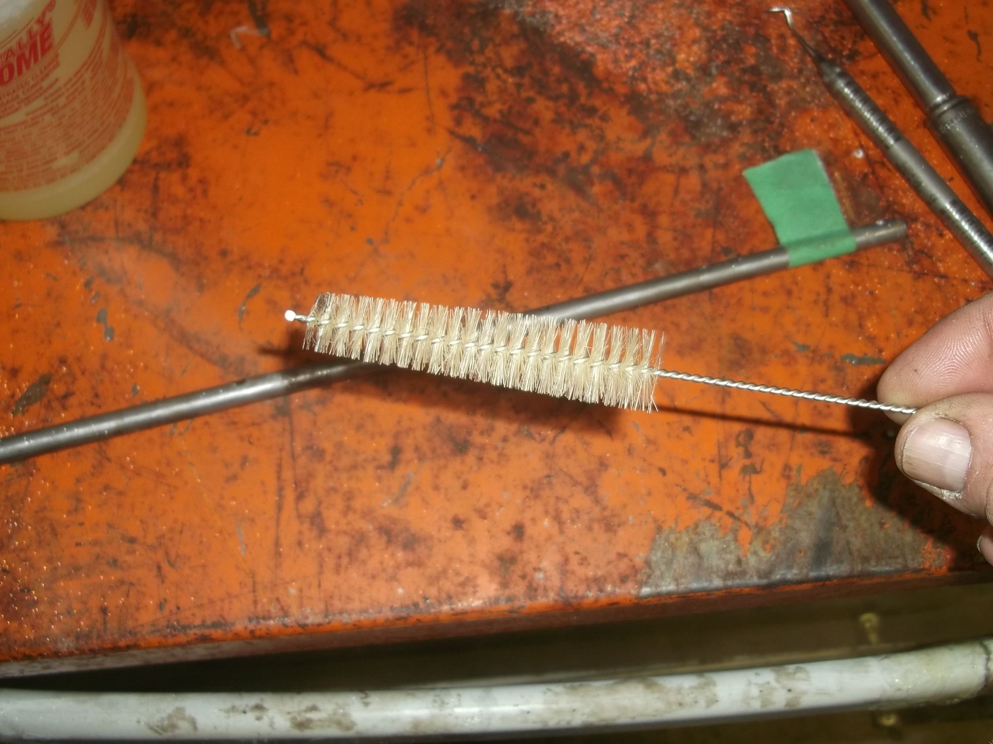

So I've been using Dr Evils favorite cleaner LA Awesome and I found this little brushes at the dollar store. They worked great.

Mark Henry   So I've been using Dr Evils favorite cleaner L...   Feb 12 2014, 04:46 PM
