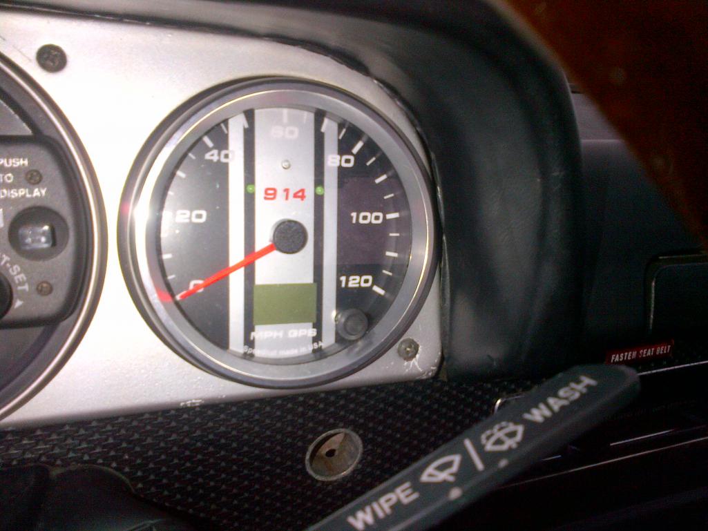

my 914 came with this when I bought it.
It is a GPS speedometer and works pretty good. Of course there is the delay upon start up and it doesn't work in the tunnels.
