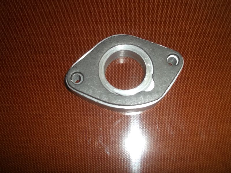

Mark Henry   I'm getting my "poop in a group" to ...   Feb 8 2014, 02:26 PM
Mark Henry   The ring was made from a type 1 VW beetle flywheel...   Feb 8 2014, 02:34 PM
Mark Henry   Believe it or not this was made on my 1942 Montgom...   Feb 8 2014, 02:38 PM

Mark Henry   Guess what I'm making :)   Feb 13 2014, 09:02 PM
Mark Henry   First hint it's not finished...damn belt for m...   Feb 13 2014, 09:11 PM
PanelBilly   HE for /6s?   Feb 13 2014, 09:13 PM
Mark Henry   HE for /6s? :lol: Another hint other side o...   Feb 13 2014, 09:41 PM
Mark Henry   next..   Feb 13 2014, 09:44 PM
Mark Henry   :) It's a jig for...???   Feb 13 2014, 09:51 PM
bigkensteele   :) It's a jig for...??? ITB adapters?   Feb 13 2014, 09:59 PM
gms   :) It's a jig for...??? restrictor plates f...   Feb 13 2014, 10:08 PM
Mark Henry   Close.....custom phenolic spacers :) The jig will...   Feb 13 2014, 10:26 PM
