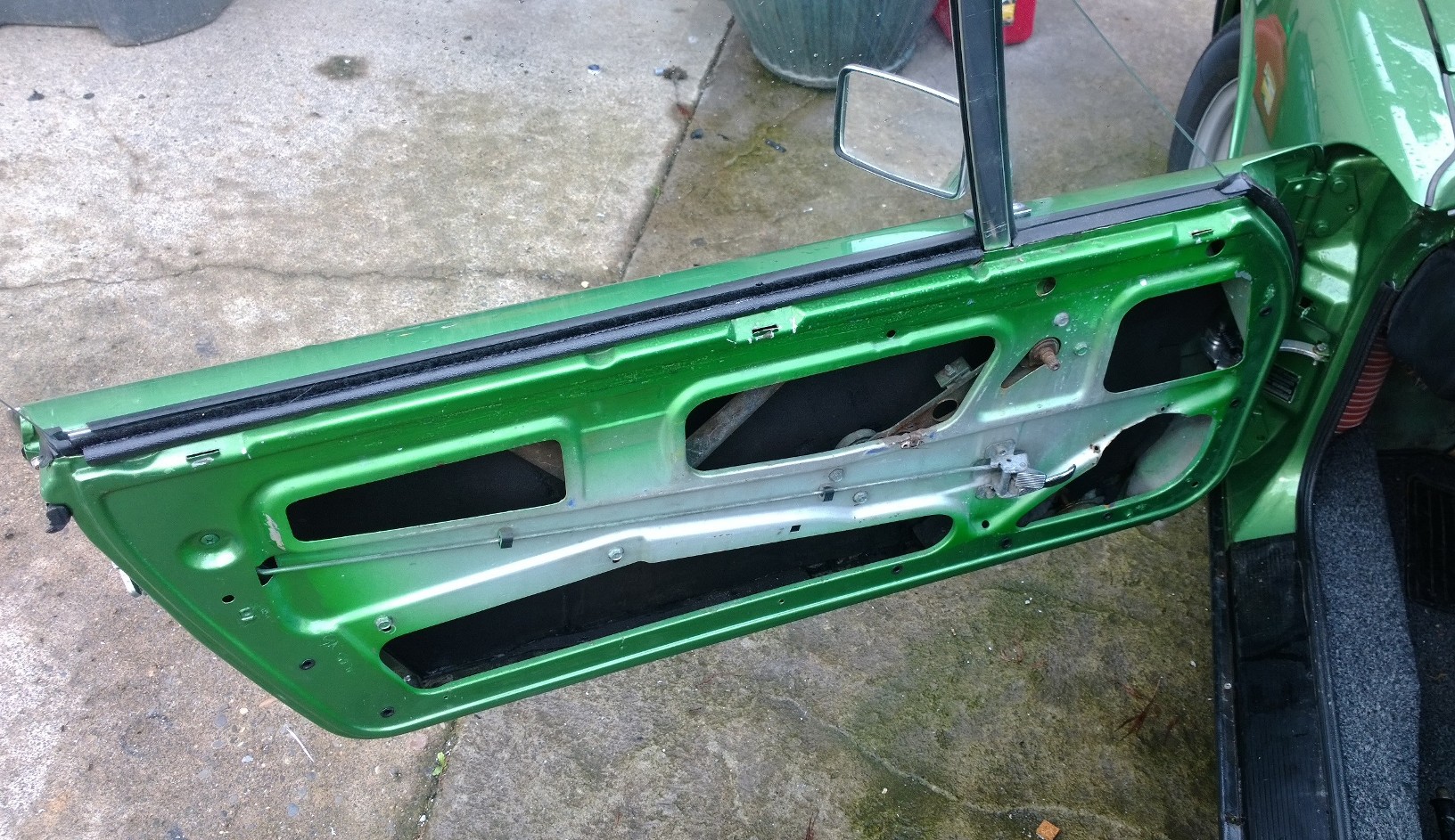

First off remove the door pockets, and plastic door handle cups. This will allow the door panel to be removed.

The door panel will remove easily by popping the door panel clips out of the door on the front rear and bottom. You can use a flat screwdriver and carefully pop them out one at a time. If you door panel is deteriorated you may want to use a clip removal tool, or a larger flat object. The panels will remove up as there are 3 clips on the top that hold the top of the panel in.
