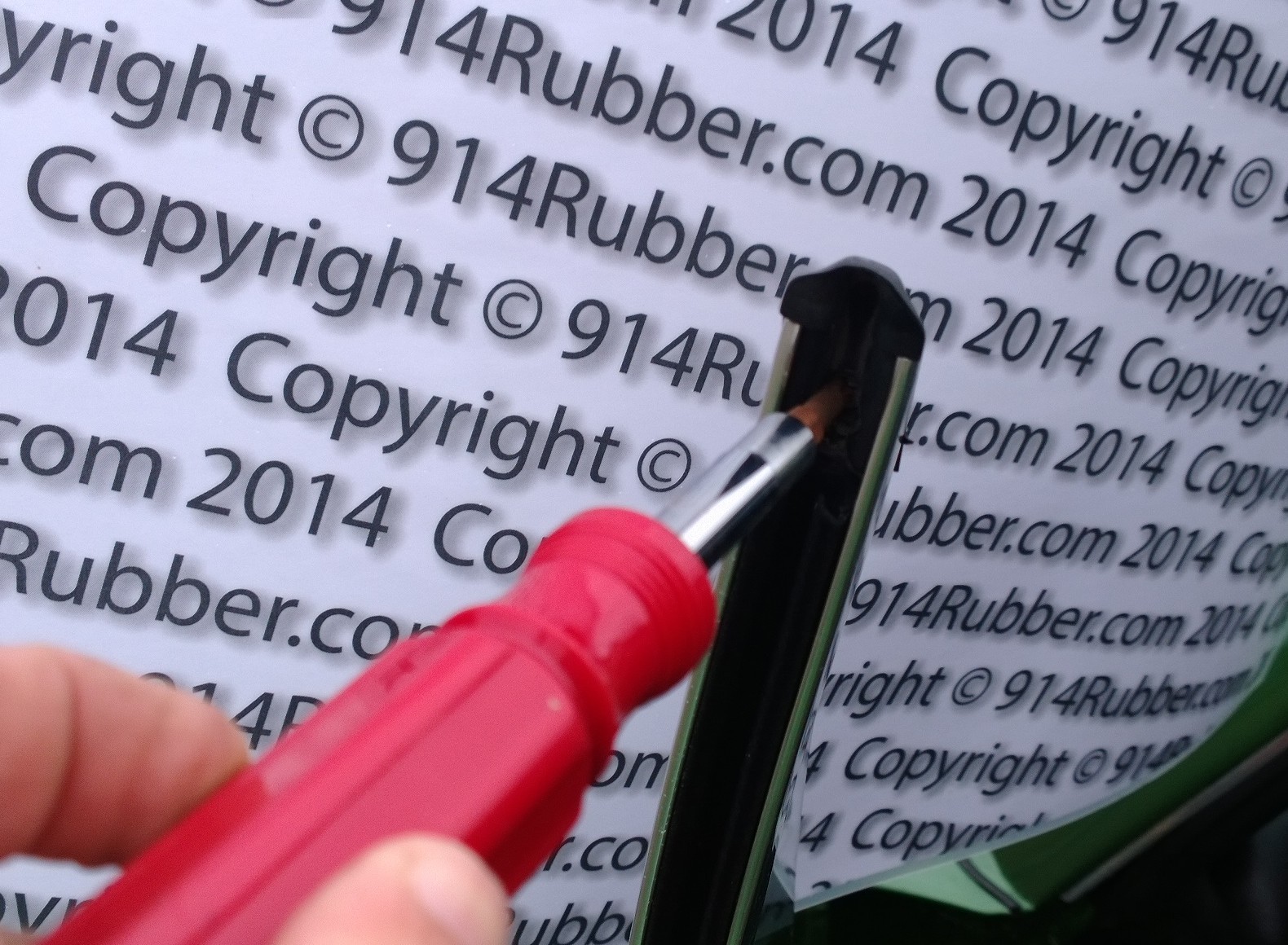

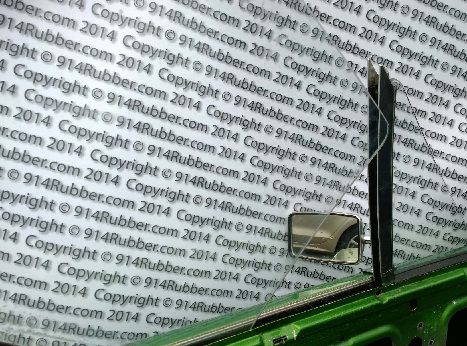

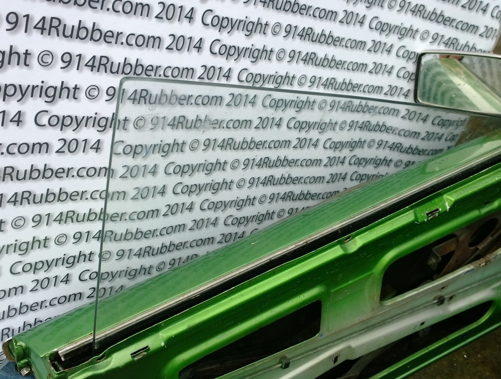

The window will remove by rotating the front down and pulling it out rear 1st.
You will find it helpful to remove the cap from the top of the window, the #2 Phillips will help.
