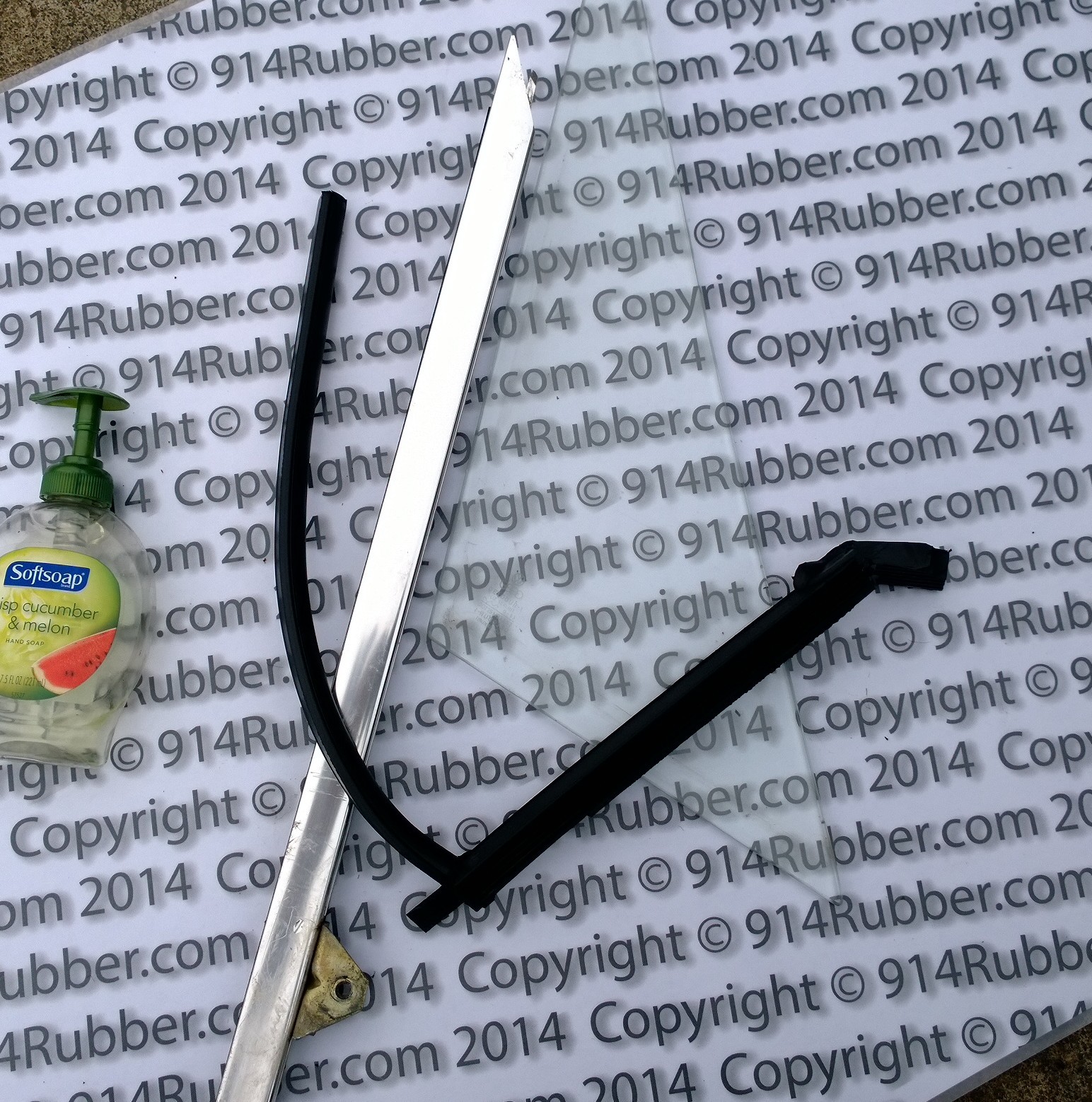

Get the new seal ready I use soapy water to slide the new seal into the track.
Shrink wrap it to hold in place. Be careful to only use where you will not have issues installing.
