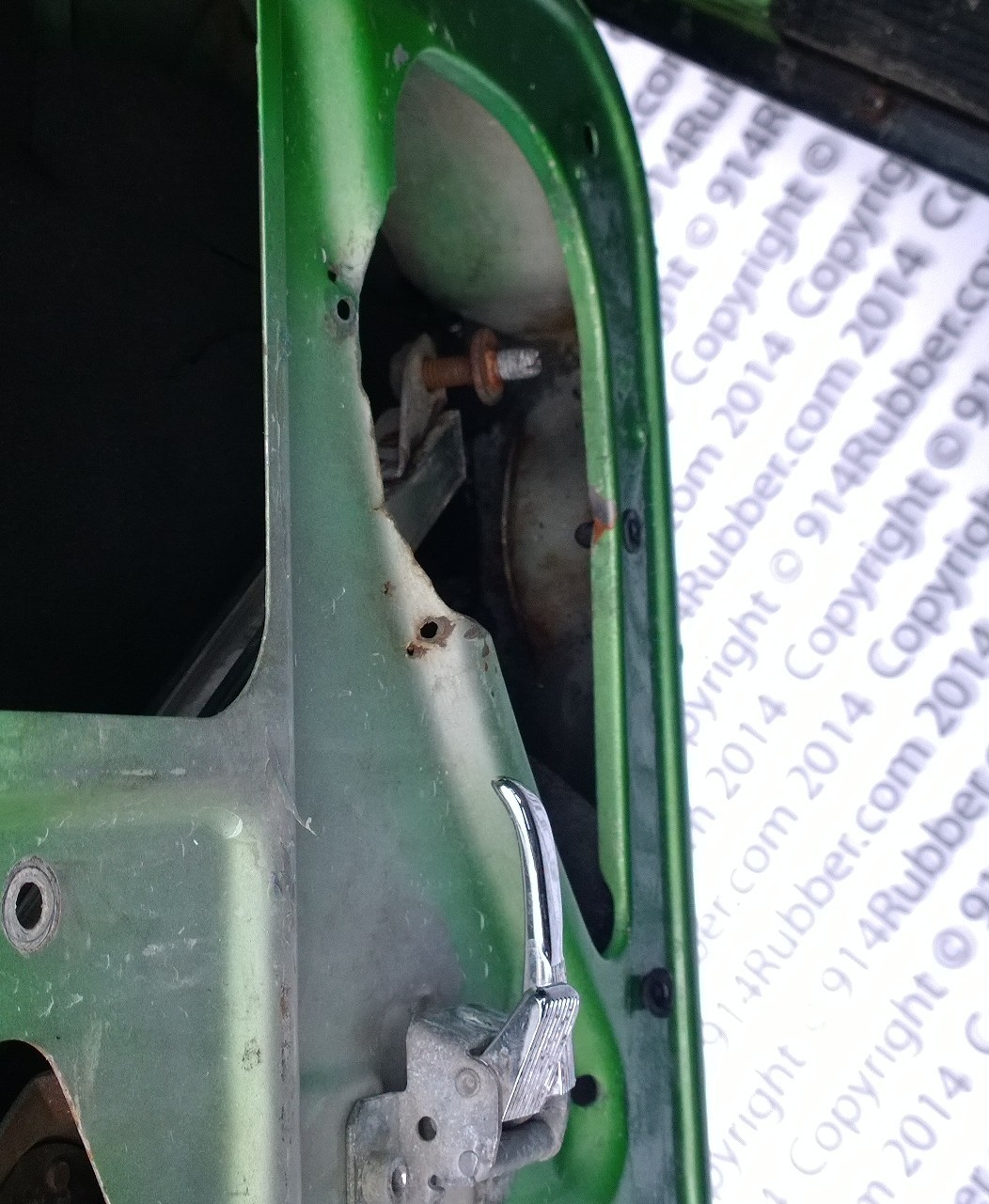

First off remove the door pockets, and plastic door handle cups. This will allow the door panel to be removed.

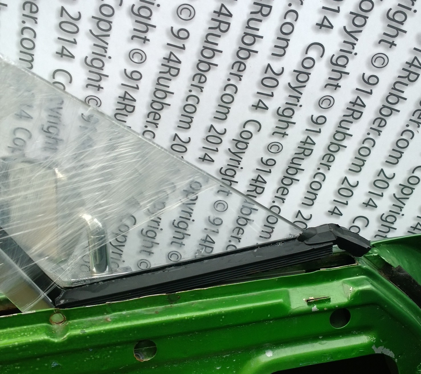

Install the base 1st. As soon as the bar is in, put the screw back in the base, just screw it all the way in to get adequate clearance.
