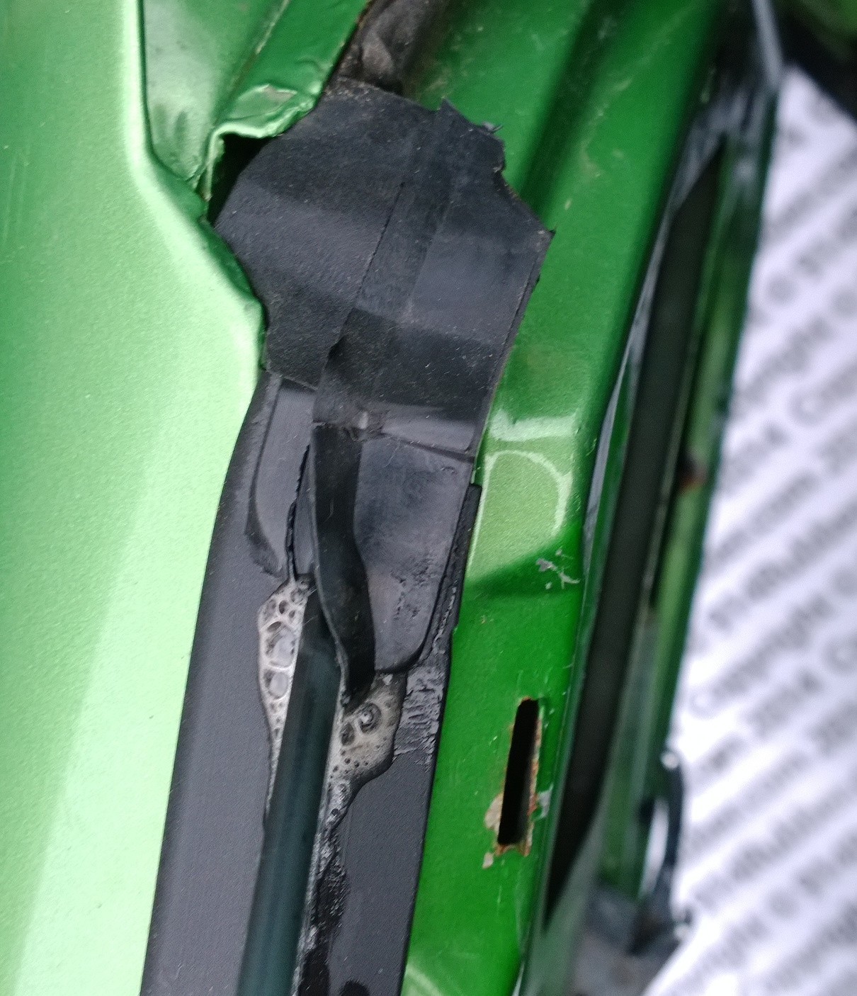

You will need to put the center bolt back in. Push it forward, and push the seal into place. I used a wood block to tap the seal into place.
The factory manual says you can glue the seal to the outer door seal, but mine popped into place after I played with it.
