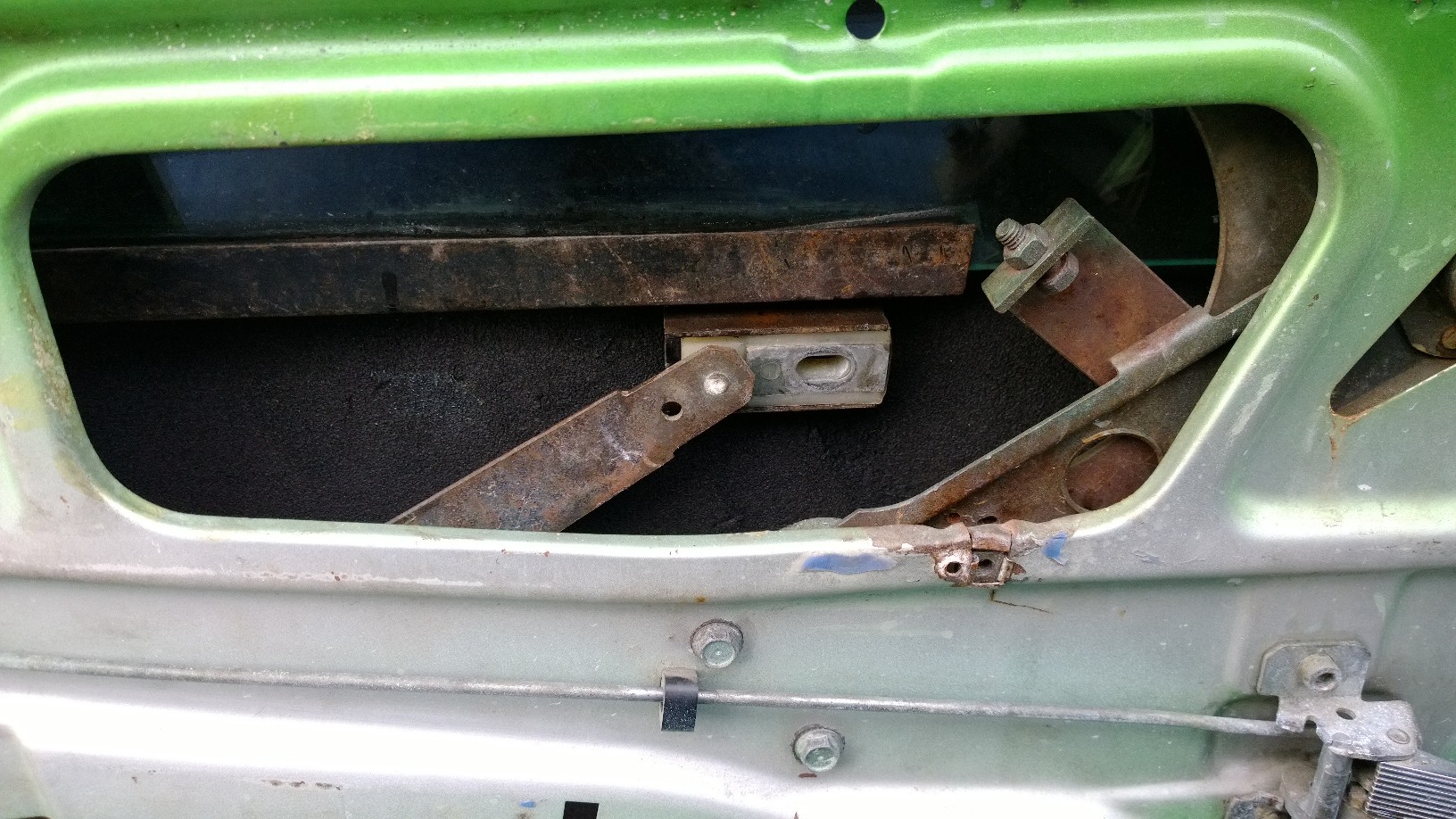

First off remove the door pockets, and plastic door handle cups. This will allow the door panel to be removed.

You will need to re install the 13mm bolt into the base of the window mechanism. This is the one you removed earlier.
Also reattach the mechanism to the door. You will have to move it around to make it fit.
