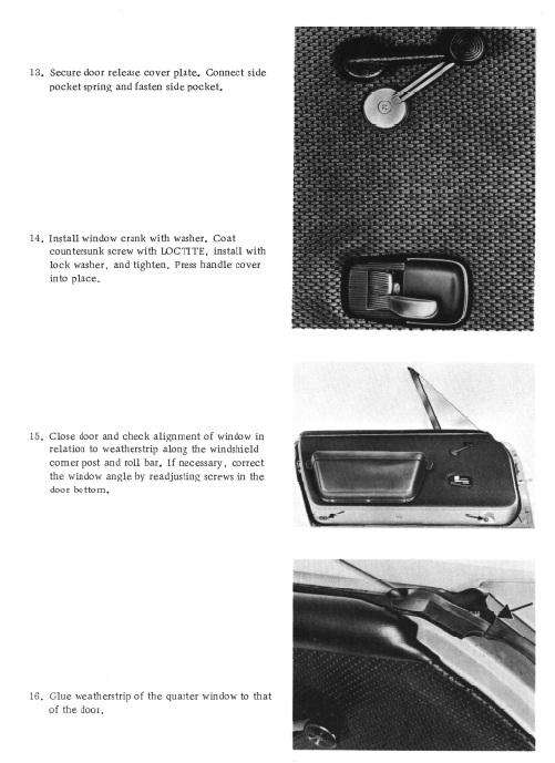

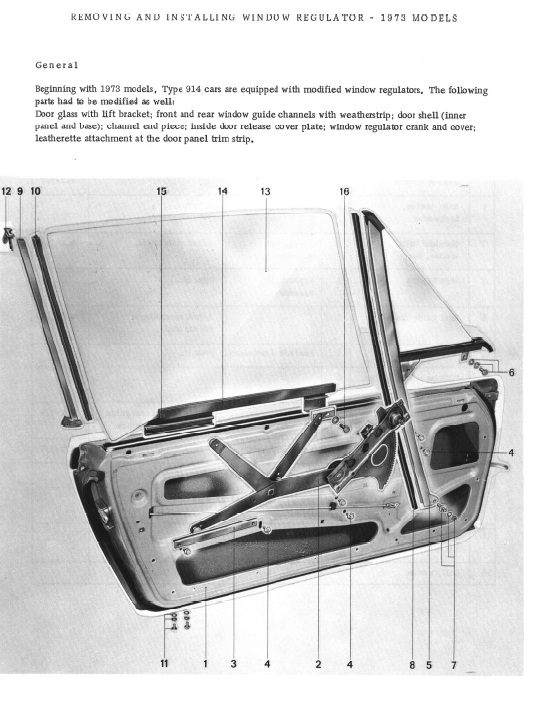

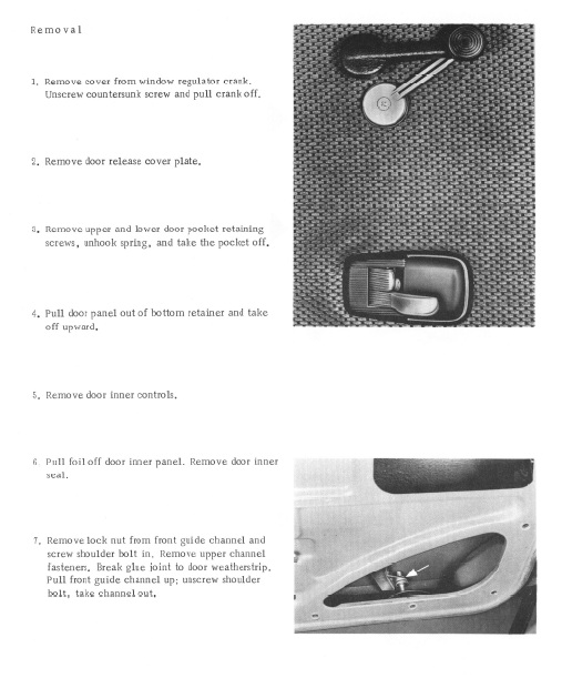

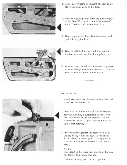

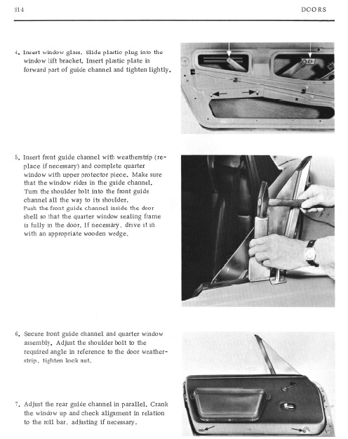

The OEM version. I think my technique was easier, you can be the judge.
