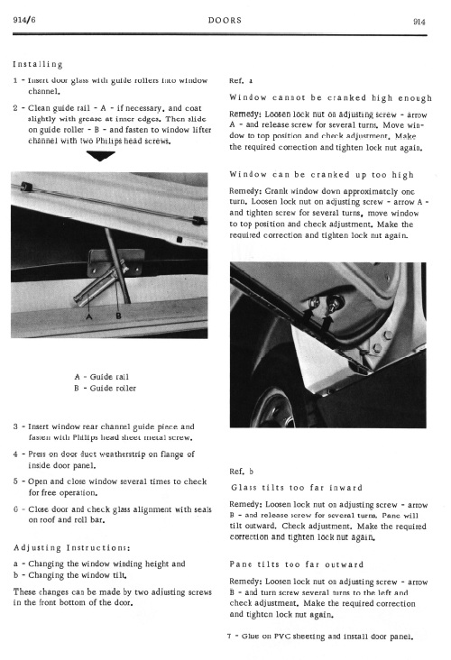

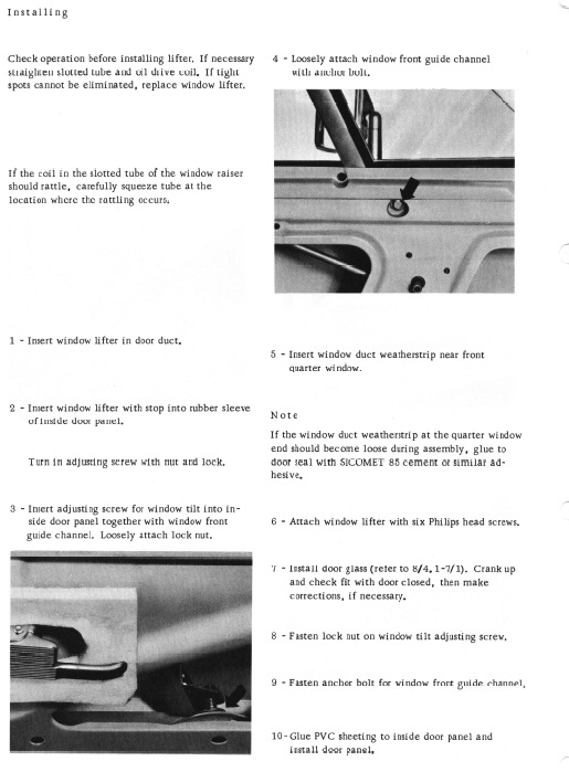

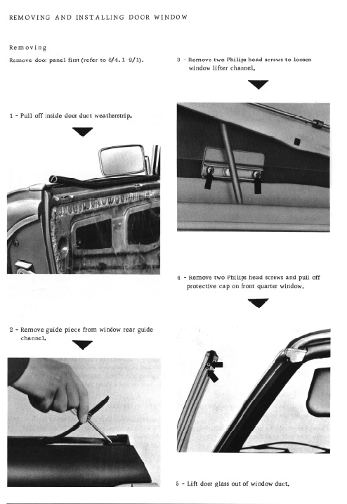

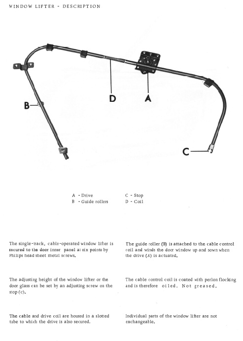

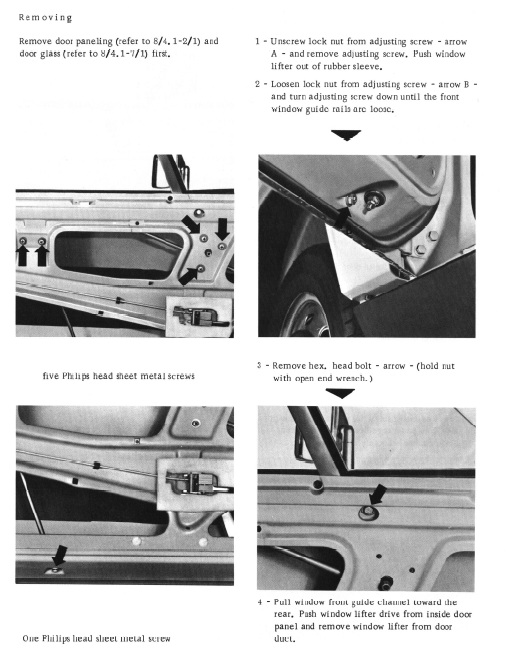

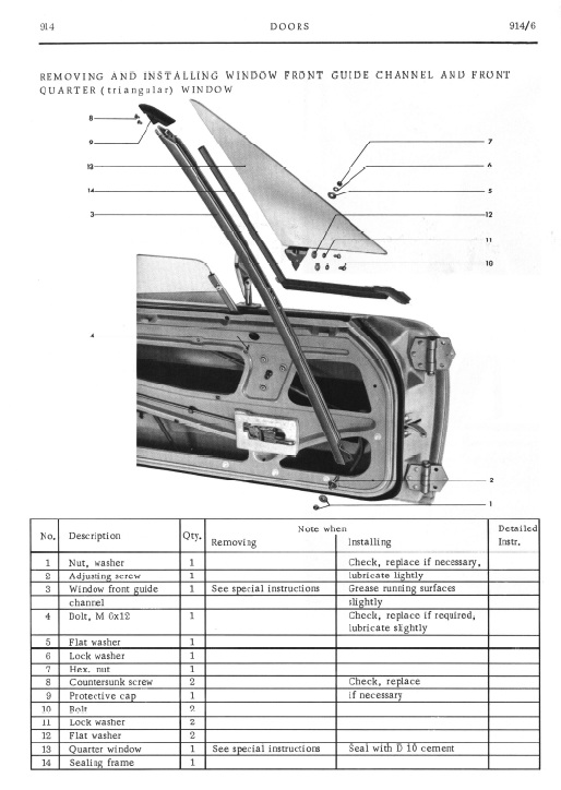

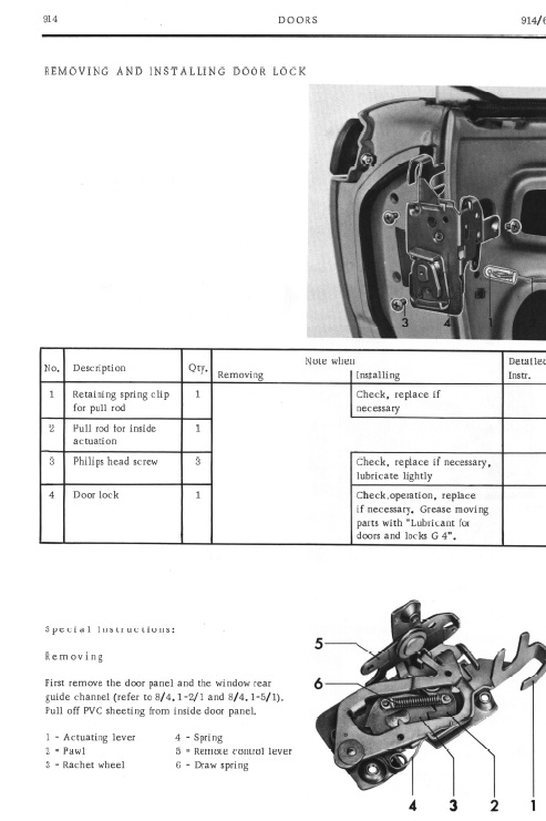

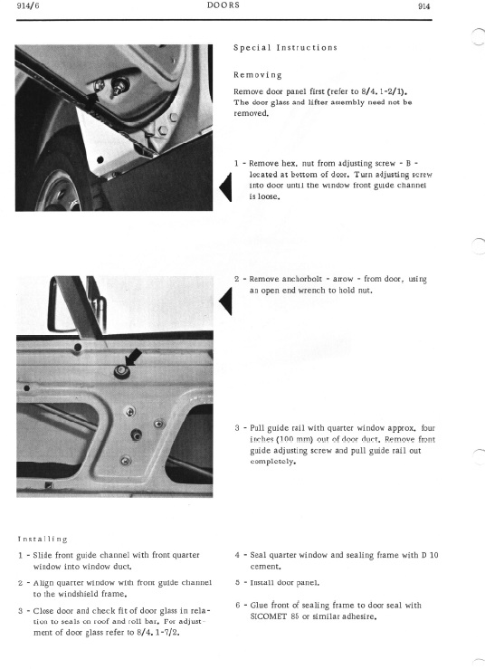

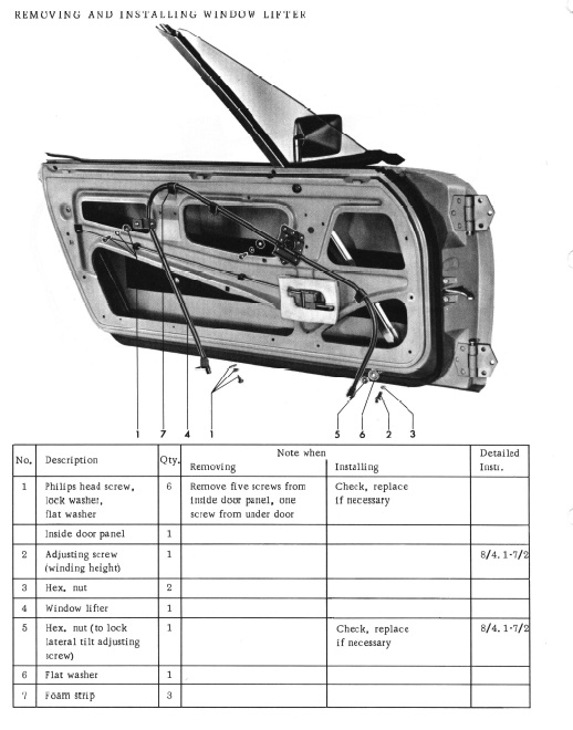

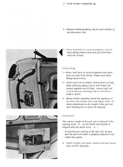

The early version door
Attached Image Attached Image Attached Image Attached Image Attached Image Attached Image Attached Image Attached Image Attached Image Attached Image

rudedude   Mark, On the early style door the triangle seal h...   Apr 16 2014, 05:28 PM
BeatNavy   Mark, On the early style door the triangle seal ...   Jun 11 2016, 04:24 PM
Mikey914   I don't have an early car. The part number is ...   Apr 16 2014, 11:32 PM
914werke   Ive found that support on later doors as well. Iv...   Apr 17 2014, 07:47 AM
horizontally-opposed   Seconding the motion to make this thread a classic...   Sep 4 2015, 04:01 PM
Mikey914   Thanks guys.   Sep 4 2015, 07:56 PM
Mikey914   You can cut a relief in the back of the seal or re...   Jun 11 2016, 07:23 PM
BeatNavy   You can cut a relief in the back of the seal or r...   Jun 12 2016, 04:26 PM
Mikey914   [quote name='Mikey914' post='2358138' date='Jun 1...   Jul 13 2018, 09:37 AM
roland914   Thanks guys for your input, Was trying to do the v...   Jul 13 2018, 12:32 AM
roland914   Up date Guys, took the window regulator, door glas...   Jul 17 2018, 01:00 AM
