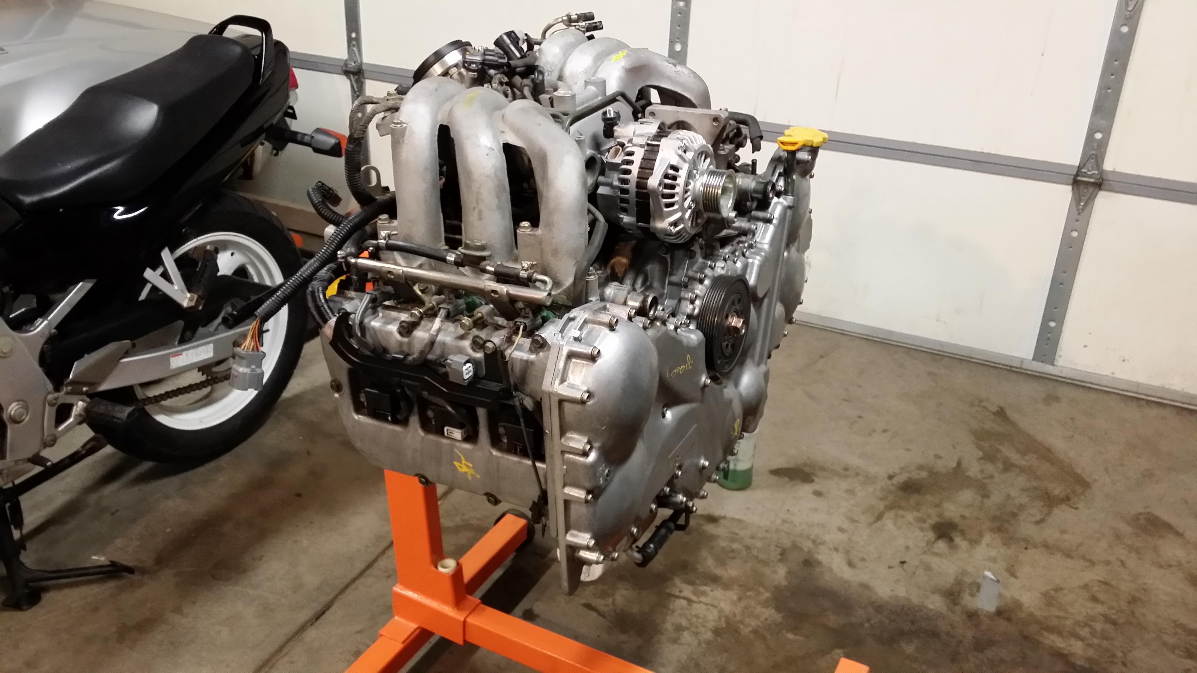

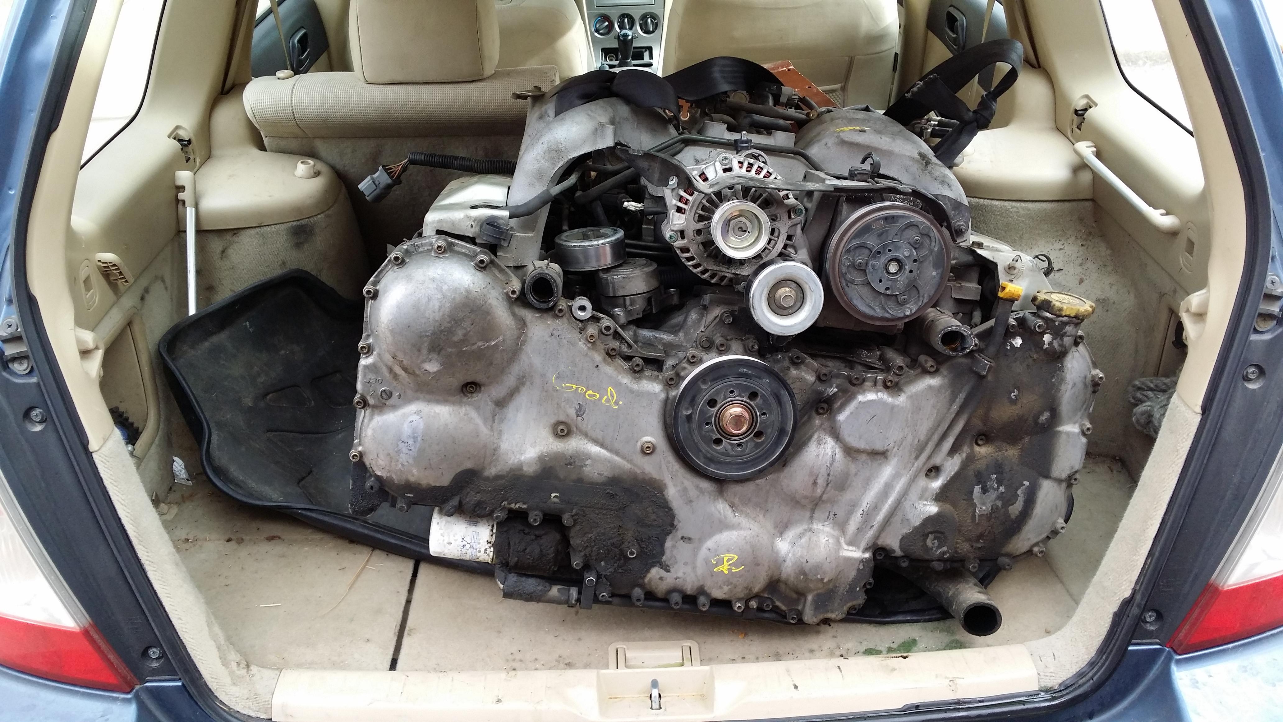

Wow! It has been a while since I have updated this thread!!
Fast forward two years and I am now out of grad school and working in Denver! After a few seasons of auto crossing and a few track days I decided I wanted a power plant with similar power to my 2.4L big 4 but with better street ability so I could enjoy driving it at places other than the track!
After much deliberation I settled on this. The Subaru EZ30. I'm intending to base my build heavily on 76-9 14's because of the phenomenal level of documentation included on every step of the process!
76-914's thread: http://www.914world.com/bbs2/index.php?sho...=201776&hl=
So far I have acquired the engine and a temporary inexpensive transmission, along with Ian s engine Cradle.
Hopefully my car won't be out of commission for to long!

rnellums   It's coming together!   Feb 19 2014, 04:43 PM
Chris H.   Sweeeeet! Looks like a nice clean engine to s...   Feb 19 2014, 05:26 PM
rnellums   Sweeeeet! Looks like a nice clean engine to ...   Feb 19 2014, 06:01 PM
brant   fun.... I want a ride when its finished   Feb 19 2014, 06:12 PM
rnellums   fun.... I want a ride when its finished I...   Feb 19 2014, 06:20 PM

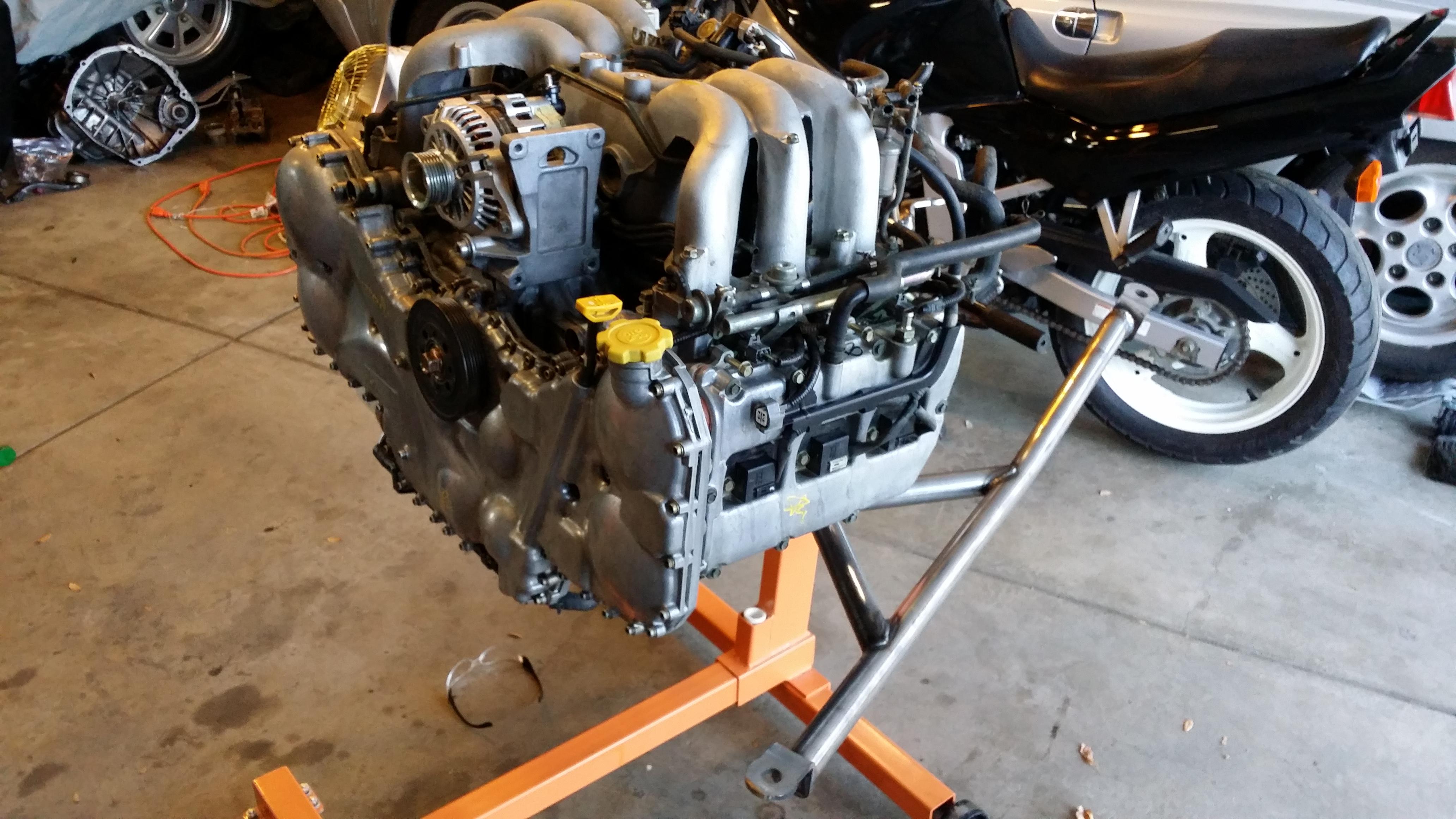

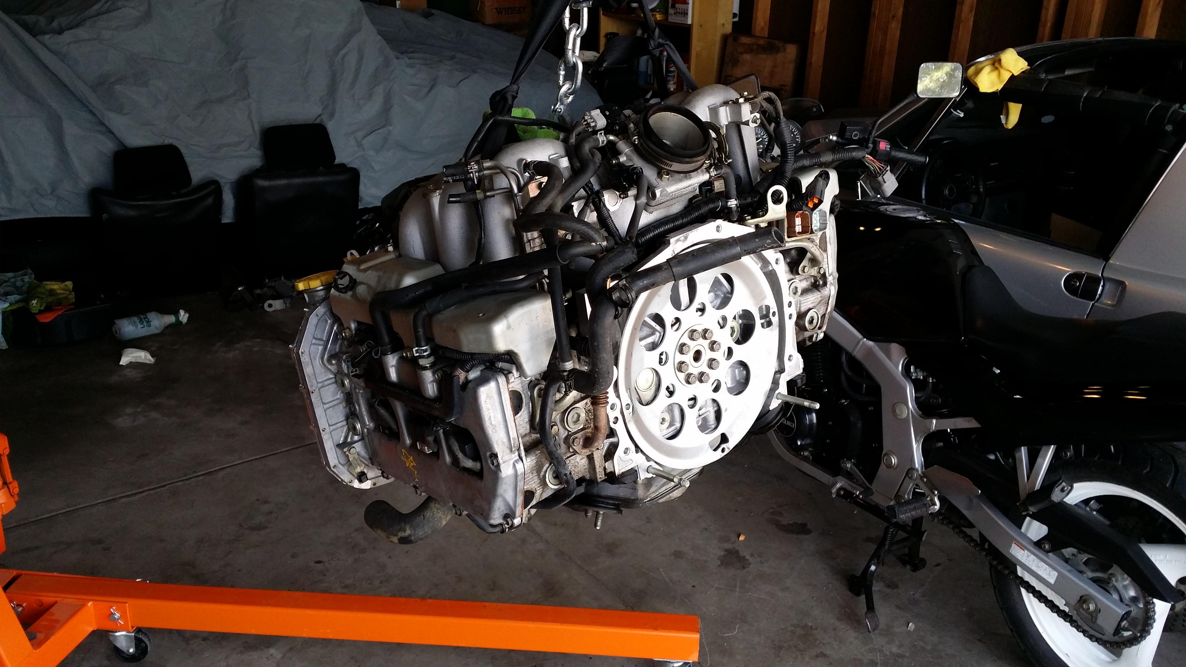

rnellums   I spent some time tonight working on the 2nd subar...   Feb 19 2014, 10:04 PM
1stworks   :Qarl: Sweet!!!!!!...   Feb 20 2014, 08:23 AM
