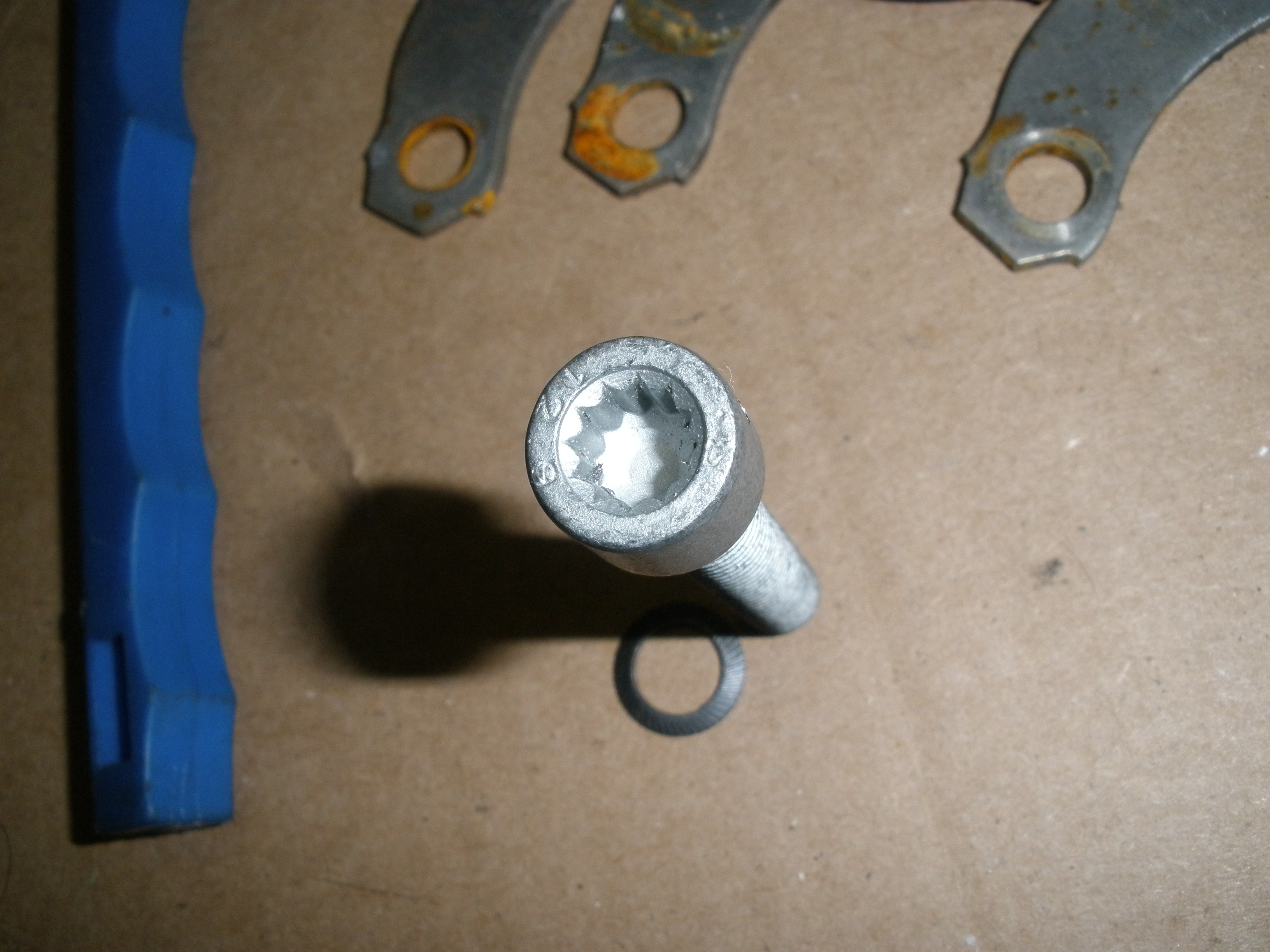

Will a six point strip out the 12 point torex bolts for the CV joints (it only takes 30 lbs....)
Or should I go buy this difficult to find torex?
Anyone got a link?

914itis   I heard vw parts store.   Feb 19 2014, 06:18 PM
Jeffs9146   Most FLAPS has them in a pack of 6 pieces in diffe...   Feb 19 2014, 06:20 PM
HalfMoon   Pelicans got it but pricey :-( http://www.pelicanp...   Feb 19 2014, 06:22 PM
2mAn   I found mine at NAPA. three different sizes , 3/8...   Feb 19 2014, 06:24 PM
HalfMoon   I found mine at NAPA. three different sizes , 3/8...   Feb 19 2014, 06:28 PM
Jeffs9146   12 Point Tripple Square Tips   Feb 19 2014, 06:26 PM
HalfMoon   12 Point Tripple Square Tips 54.99? Pelican sin...   Feb 19 2014, 06:28 PM
chads74   I bought mine on Amazon, think they were $5.9...   Feb 19 2014, 06:47 PM
HalfMoon   I bought mine on Amazon, think they were $5....   Feb 19 2014, 07:10 PM
HalfMoon   Sears for 18.95 http://www.sears.com/kd-tools-3-8-...   Feb 19 2014, 06:50 PM
The Cabinetmaker   I've never heard of torex. Do you mean torx? I...   Feb 19 2014, 07:09 PM
jim_hoyland   Pep Boys. 8mm $7 The CV bit is also referred ...   Feb 19 2014, 07:30 PM
somd914   Also got mine at NAPA, been 2 or 3 years, purchase...   Feb 19 2014, 07:40 PM
HalfMoon   Deeper search at Sears and I found it in a 1/4 dri...   Feb 19 2014, 10:04 PM
stugray   I found them at Autozone in a pack but you have to...   Feb 19 2014, 10:42 PM
rick 918-S   Don't use a torx. They will strip and you will...   Feb 19 2014, 10:59 PM
HalfMoon   Don't use a torx. They will strip and you wil...   Feb 19 2014, 11:10 PM
Cap'n Krusty   You DO NOT want a 1/4' drive 8mm triple square...   Feb 19 2014, 11:23 PM
CptTripps   Less than $15 here. Free shipping for Prime m...   Feb 20 2014, 03:25 AM
jacksun   Will a six point strip out the 12 point torex bol...   Feb 20 2014, 07:48 AM
shuie   FLAPS, ask for a Triple Square. Should be ~$1...   Feb 20 2014, 08:35 AM
Olympic 1.7   I got this set from amazon. It works pretty good, ...   Feb 20 2014, 08:42 AM
OU8AVW   Snap On Why f- around? I've spent almost as m...   Feb 20 2014, 08:43 AM
JStroud   I bought mine from Tangerine racing, racer Chris i...   Feb 20 2014, 08:54 AM
Mark Henry   $5.95 http://www2.cip1.com/ProductDetails.as...   Feb 20 2014, 11:25 AM
Thestigz06   Any vw parts website. I think mine was empi! :...   Feb 20 2014, 01:34 PM
HalfMoon   I opted for the 3/8, 12pt, 8mm, long shank at NAPA...   Feb 20 2014, 01:44 PM
chads74   Good decision!   Feb 20 2014, 01:56 PM
The Cabinetmaker   When you insert the tool, tap it with a hammer and...   Feb 20 2014, 03:35 PM
HalfMoon   When you insert the tool, tap it with a hammer an...   Feb 20 2014, 03:50 PM
Mark Henry   When you insert the tool, tap it with a hammer a...   Feb 20 2014, 04:43 PM
