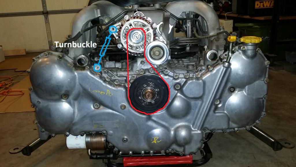

I'm laying my plan out for the accessory belts. I don't plan to run A/C, and I have no need to run the power steering pump, so I plan to remove those from the system. The idea is to attach the alternator on the swinging end to a turnbuckle type strut connecting it to the engine case, and using the alternator itself as the tensioner, much like the layout on the 914. I've drawn my anticipated layout on this image.
Anyone see anything that looks absolutely terrible?

QUOTE(rnellums @ Feb 22 2014, 01:01 AM) *
The 818 kit car guys have this option: alternator bracket if you don't want to do your own design/fab work.

QUOTE(Gary @ Feb 22 2014, 08:56 )
That's looks pretty handy! Thanks. I think mine should be able to bolt on without any fabrication, but that will make an excellent backup.
