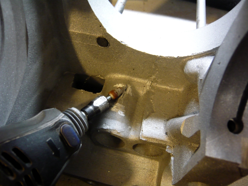

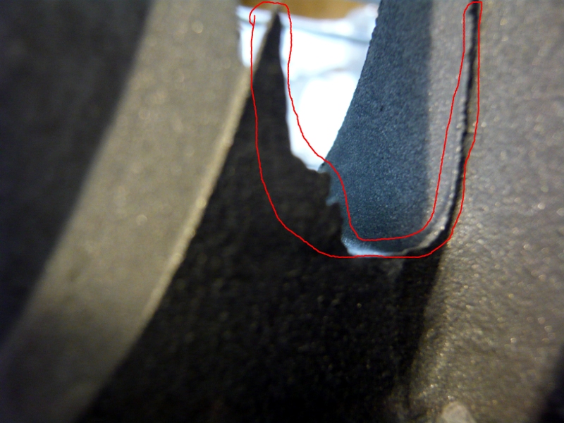

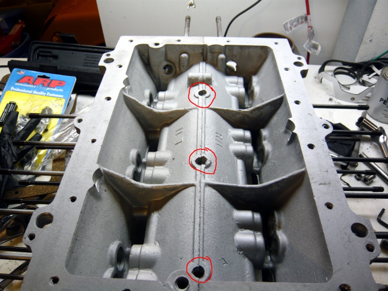

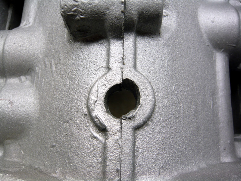

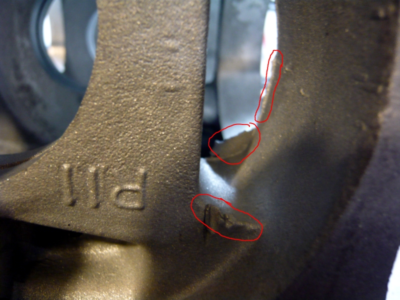

So let us sit upon the ground and tell sad stories of case preparation. While I really dig the design of this six cylinder engine, I dislike the "let's crank out fifty more of these before lunch" attitude GM seems to have had in terms of production. In my not-at-all humble opinion this always irked me about the American Big-3 - often some very cool engineering ideas but watered down to hit a price point.
Take this aluminum case for example. I like that the case is just big enough to provide for six cylinders. I love that the rotating assembly just fits inside to maximize a small space. The construction is strong and simple. But these were obviously not hand built by German union labor who cared about their craft. Observe the crazy volume of casting flash in the block hemispheres:
Also observe how the oil drain holes on the bottom of the case don't even match up. For that matter, neither do the tops of the walls for the journals. Luckily, I can easily clean all of this up. Specficially, I bolted the case together and used a 7/16" drill bit to clean up the drain holes.
That's actually the good news about all of this. GM may not have cared about this, and clearly the engine ran for 40 years before failing. However, Marcus DOES care and was rewarded with a HALF CUP of casting flash at the end of the exercise.

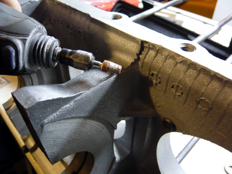

It's also time for an unpaid commercial plug: Here I'm using the my fourth and LAST DREMEL EVER to remove case flash. Pro Tip: I finally got sick of replacing Dremels every few months so I replaced it with a Proxxon rotary tool (part #FBS 115/E) made by the nice people living in Luxembourg. Matched with a Flexishaft, this tool is superior in every way. It's quiet. It's comfortable. It has an adjustable chuck instead of a 1/8" collet so you can use a far wider array of bits. Another Pro Tip: McMaster-Carr has a ton of rotary bits that cost half of what Dremel bits cost and last longer. For example, I bought eleven brass cone brushes for $1.48 each. It's a money saver for sure.
[/shameless plug]
The part that took the most amount of time were the valleys above the center of the lifter bores. There were casting pockets full of little bits of crud; something like an undersea cave system. This took some serious time to grind down. It also reinforced my plan to proceed with an application of GE Glyptal paint.
