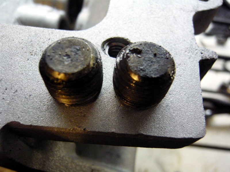

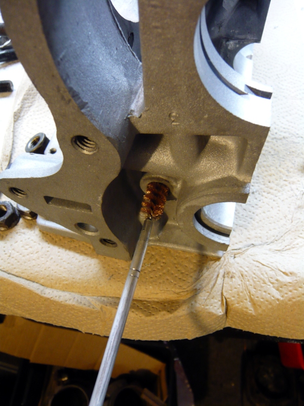

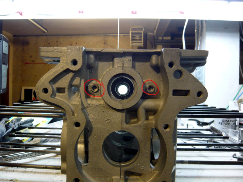

When the week of grinding had finally come to an end, it was time to make some decisions about the case. For example, in the very handy book Performance Corvairs: How to Hotrod the Corvair Engine and Chassis, it is recommended to widen each of the oil passages behind the main bearings to 3/16". Indeed, the passages are supposed to be 1/8" from the factory but they actually waver all over the place from .09-.14". I called up Corvair engine machinist Ray Sedman to ask about this, but he said it's better to try to even them out to just a hair over 1/8" and then cut them slightly deeper. This way you get more oil flow as well as the full surface support for the bearings. Grand idea. When the case goes to him for the VW cylinder modification he'll take care of that with a big expensive machine.
Also, some have repeatedly told me not to remove the oil gallery plugs when performing case prep for fear of something or rather. But for the sake of completeness I wanted to open them up anyway, especially since the case was glass bead blasted and knew the case would get cleaned about a dozen times before final assembly. Check it out:

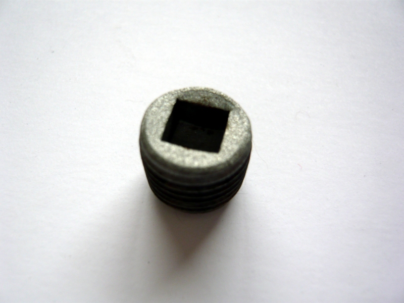

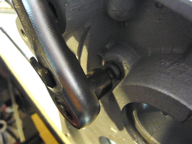

The two case plugs are 1/4" NPT plugs with 1/4" square drive sockets. They're made of steel and held in place with some sort of sealant. I used a 1/4" ratchet to remove them but would have preferred a perfectly square tool without the ball on the side.

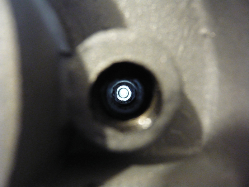

In later years, GM replaced these with aluminum hex-socket plugs and so will I. You can see the oil galleries are about as clean as a coal mine even after the case has been blasted and pressure washed a couple of times.
So it's a series of brass engine case brushes from FLAPS to suggestively clean the gallery, which with a little kerosene worked like magic.
