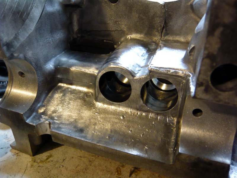

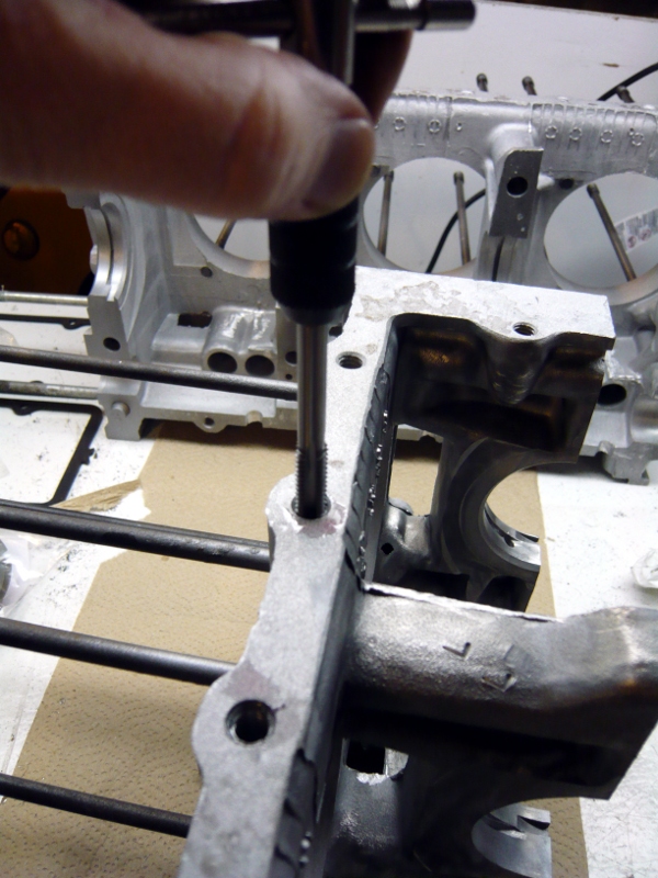

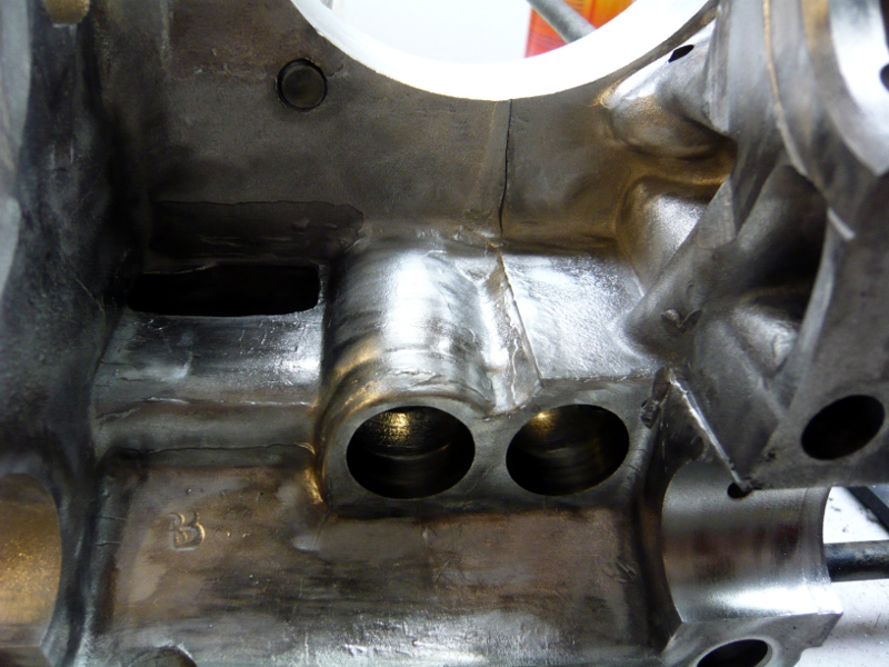

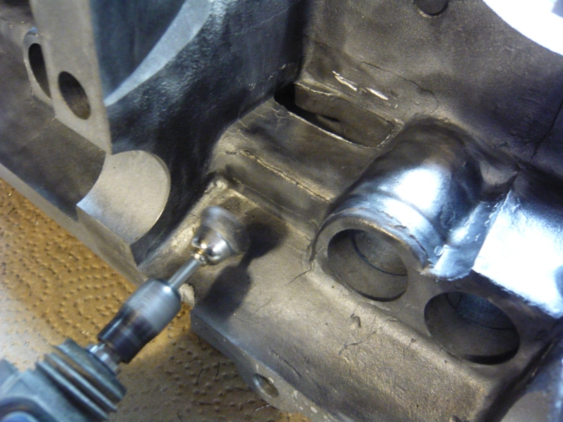

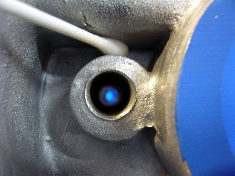

Now that the case is clean it's time to really clean the case. And I mean Mommy-Dearest-toothbush-and-bleach-on-the-tile-floor-clean. Why? Glad you asked. First, I'm polishing the innards of the case for the sake of removing unseen debris - like rounghess, impregnated glass, microscopic bits of this and that. I could have left it there but since I'm taking the extra step of painting with Glyptal paint, the surface needs to be operating room clean.
First: brass brushes and the last moments of my crappy old Dremel before switching to the Roxxon.
And then the whole of the engine gets cleaned with a thousand coffee filters and denatured alcohol until no discoloration can be seen on the white coffee filters. Coffee filter paper is cheap, strong, absorbent, and lint-free. They're the perfect tool for the job. After the coffee filters come the Q-tips, with which I used half a box, in order to really make sure that no dirt was left in any of the many many hiding places.

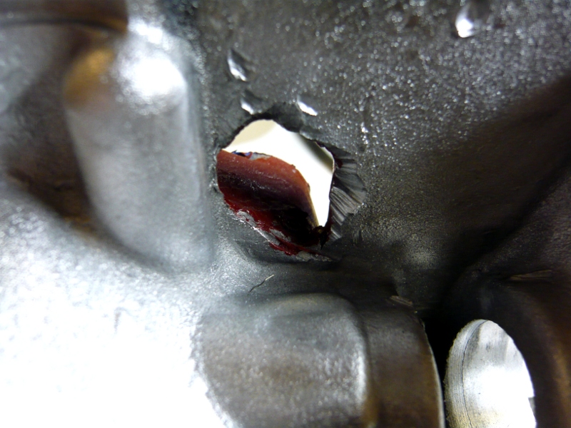

While I Was I There I took some more time to find more casting flash and more things to polish. My favorite gem by far is this oil return "hole." When I first found this my heart skipped a beat thinking that it absolutely must of have been a piece of crankshaft or bearing or something exploding right out of the case wall. Actually, this is GM's idea of a machined oil passage. Just like snow flakes, no two Corvair engine oil passages are the same thanks to what looks like a quite a blast. I polished this with great care.
This also seemed like a great time to clean out the threads for the oil pan, top tan housing, front oil cover assembly, etc. After which I cleaned them out with Q-tips, Kroil, and alcohol.

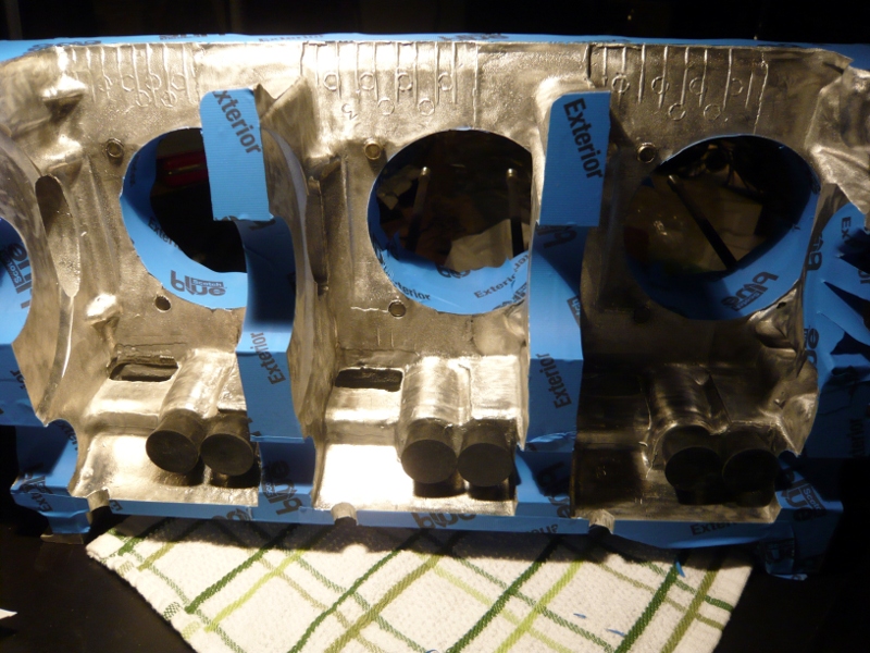

Finally, this case half is clean enough for Glyptal paint. In reading over the requisite number of Glyptal paint scare stories I found they were usually forwarded with statements like, "I don't know why this paint flaked off since I gave it a quicky clean with WD-40 and didn't bother to bake it properly afterward." Since profound cleanliness is required, profound cleanliness was executed. All told, the cleaning alone took about four days of part-time work, after a week of part-time case polishing, after another week of part-time flash grinding.
