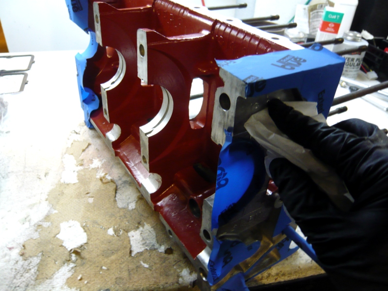

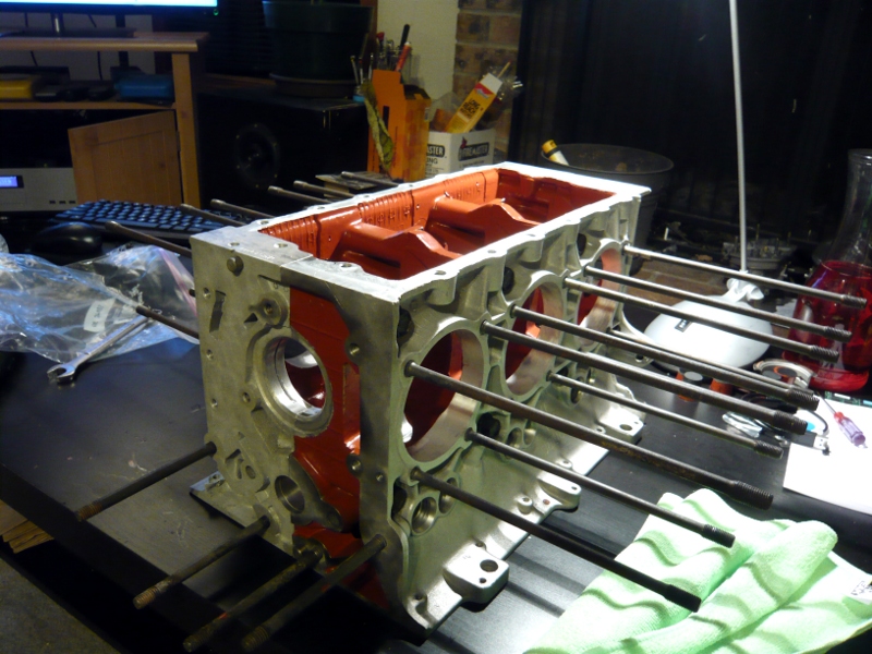

Okay. It's time for a little paint.
I gave the cases one more wipe down with denatured alcohol and compressed air. Since Glyptal is toxic, especially to people with delicate constitutions like myself, I worked one area at a time, separated by one day each, even though I was wearing a respirator and goggles. The directions on the can say to use an appropriate brush. So I used a series of 1/4" natural bristle, acid-proof model paint brushes from the hobby store.

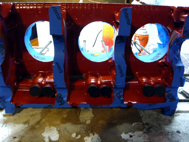

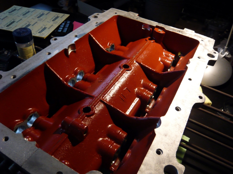

First the inside, and then after drying some more cleanup on the next side.
I was bummed to discover that the blue masking tape didn't mask very well, so I switched back to green which did a near-perfect job. Important tip: remove any slop like this with Xylene and a brass brush before it's baked on. After it's baked on there's little to be done about removing it except grinding or blasting it off.

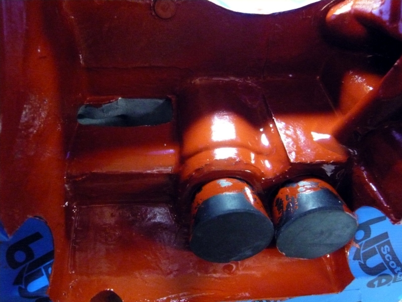

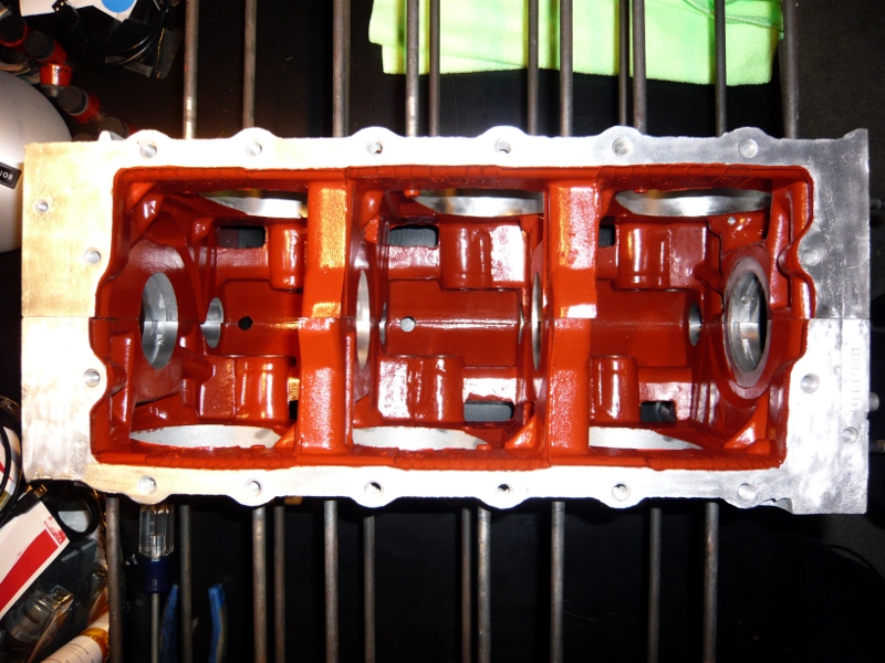

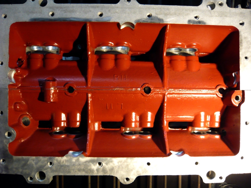

Then the bottom:

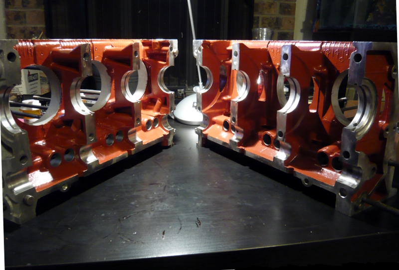

It was freezing in my garage at the time but I used my trusty Perfection Oil Heater to keep it warm for the duration. Glyptal takes a while to outgas, so it sat around for a week while I painted the other hemisphere before baking. Finally, here's a lovely smooth brick red glow after baking at 250F for two hours. And yes, this is my living room table. Since I'm a bachelor, I can get away with taking photos of the block on any surface I choose. Plus it's more fun to watch Starsky & Hutch re-runs this way.

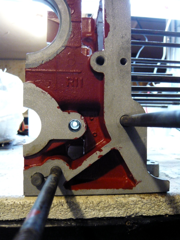

Some of the more observant viewers might see that the cylinder bores had a little paint bleed on them. Not to worry. What couldn't be removed easily will be machined off when it's time for the VW 94mm cylinder prep.
