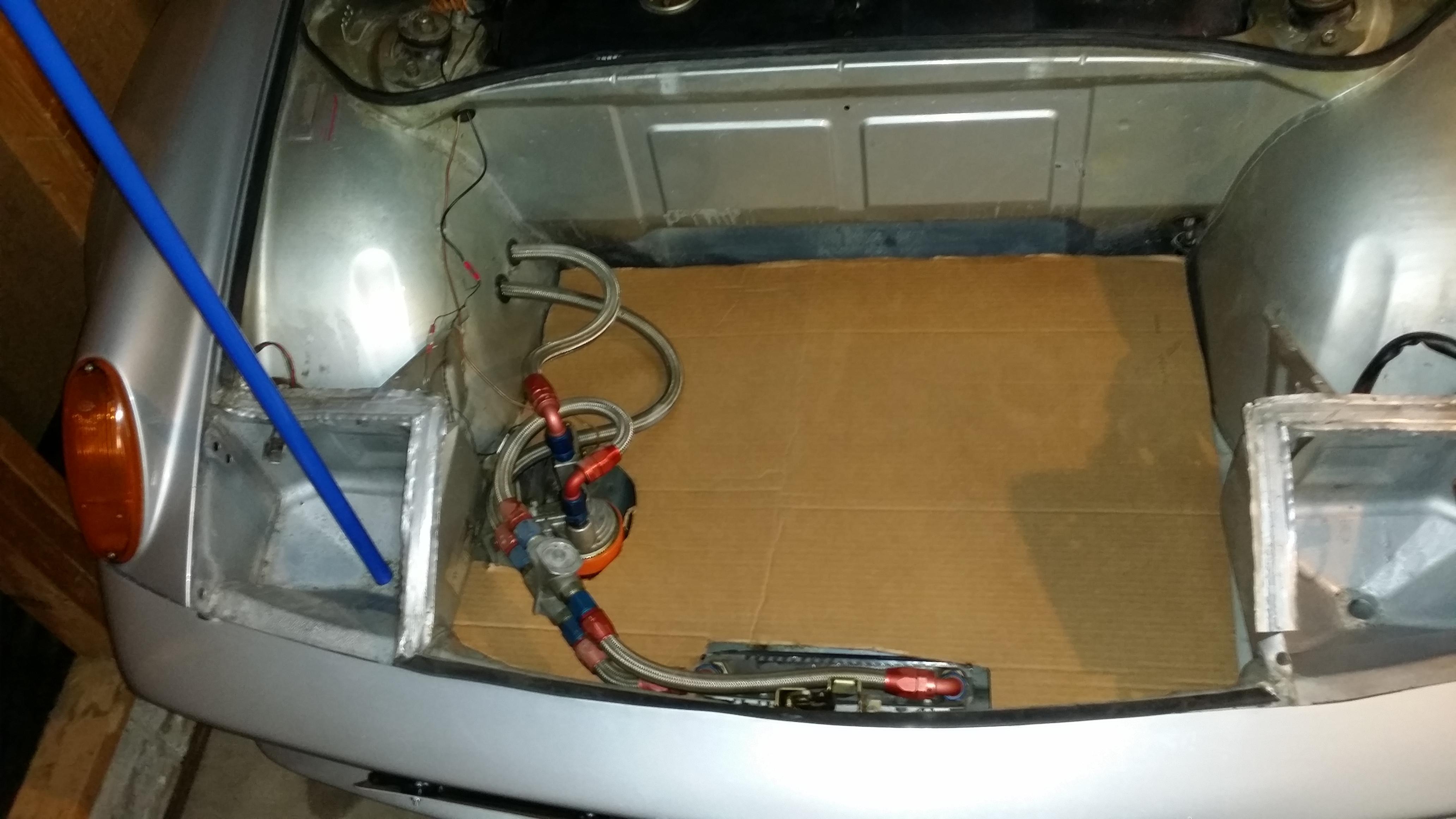

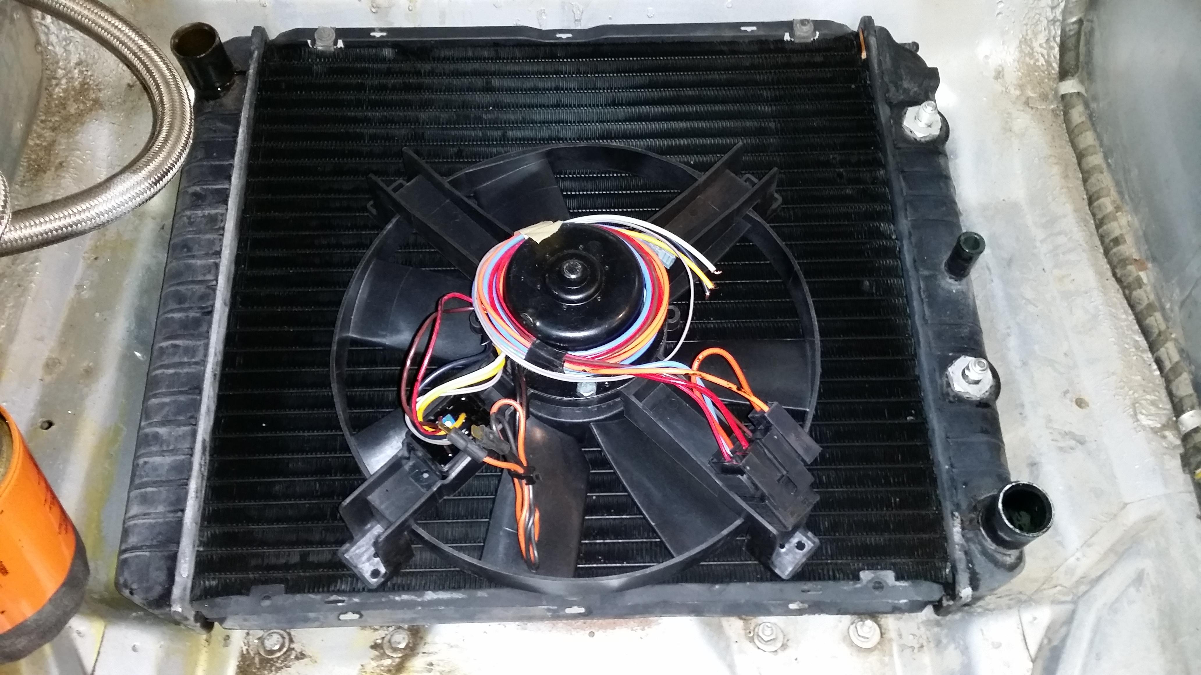

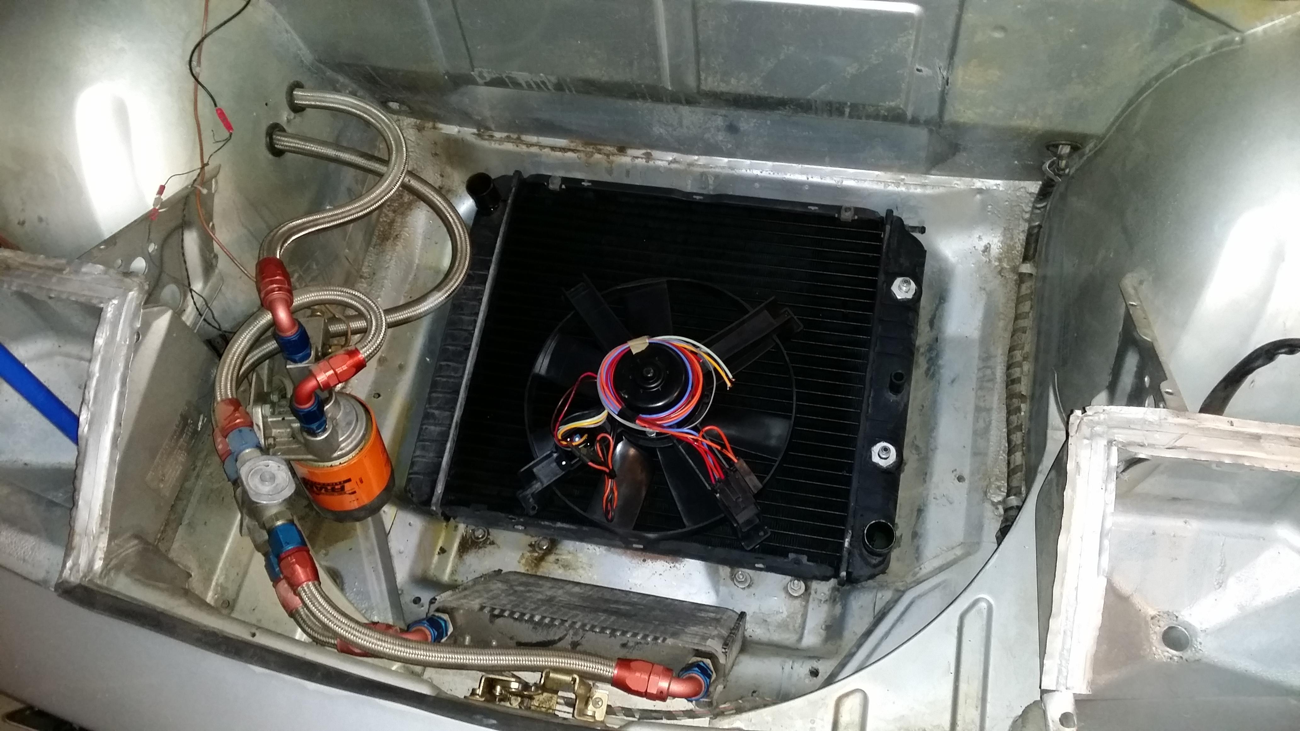

I picked up a radiator from the Junkyard today for fitting and mockup. It's off a 1982 Volvo. I understand that by doing a conversion I have to make some sacrifices, but I don't really want to give up the front trunk.
To that end, since my car already has the front trunk floor cut out, I am going to try mounting the radiator flat on the front trunk floor, mounting my pusher fan above it, and sealing it up with a floor panel similar to the stock panel. Hopefully that will a allow it to form some kind of duct!
The oil cooler will be removed as well.
If it doesn't work I'll switch to the more traditional vertical radiator.

914forme   Fans work better pulling air than pushing. I am a...   Feb 23 2014, 04:32 PM
rnellums   Fans work better pulling air than pushing. I am ...   Feb 23 2014, 04:49 PM
