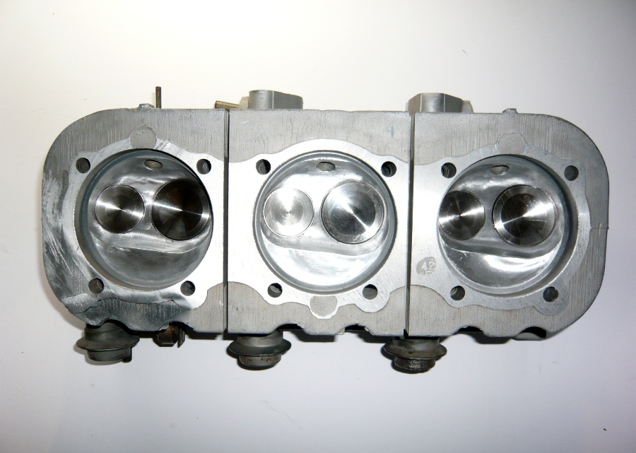

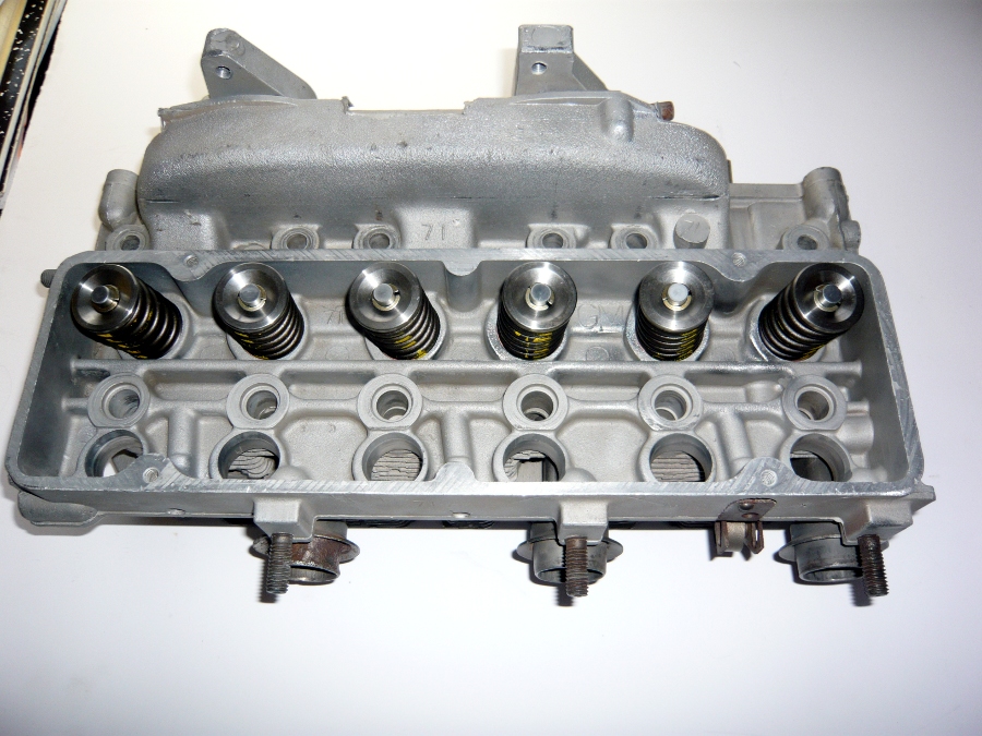

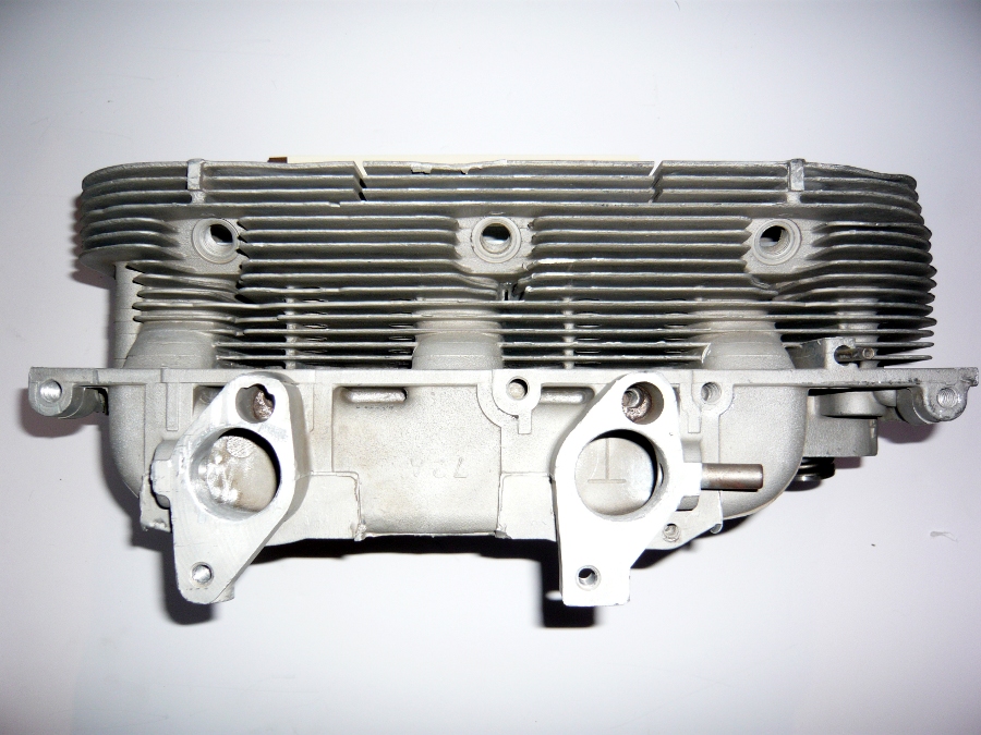

The biggest score I've made thus far are the heads. After a series of false starts I bought a pair of heads that were, astonishingly, rebuilt by Ray Sedman of American-Pi, the very same machinist doing the big bore conversion work. These were rebuilt twelve years ago but never used. One or two of the fins look to need a gentle bend, and they've already been deflashed. Most photos of Corvair heads I've seen have more flash than the case, and all of the major Corvair books strongly suggest to spend a few hours with a file through the fins. These are super, but I'll probably spend some time with a small file picking and cleaning anyway.
These heads are TITS! Wider and deeper seats, stainless valves, titanium spring retainers, silicon/aluminum/bronze valve guides, heat treated valve locks, high squish chamber machining, chrome-moly retainers, new cylinder mating surface, etc. The friggin' WORKS... for $700 from a true gentleman who bought them and never used them after spending $1575 in Year 2002 dollars.
For all the detail I'm putting into this thread I apologize that I have no photos of their rebuild process, but here are the pics that I took today.
This means that as of now I have all I need to deliver the parts to American-Pi for the VW big bore conversion. My plan is to drive them to LA from Portland myself because there are friends I want to visit there anyway. This will take a few months easily. In the meantime, all of the crank/cam/rolling assembly is back from cryogenic treatment and off to Gary the IncrediMachinist to be balanced.
