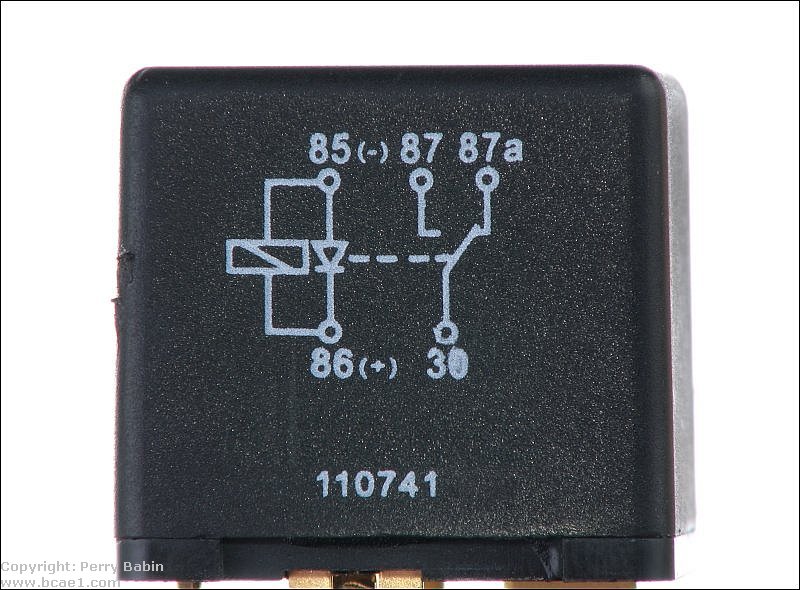

See the black mark? That is what happens to the contacts in your ignition switch every time you start your car!
And another thing that makes the arcs worse is the reverse EMF voltage spike from the magnetic field in the solenoid collapsing when you open the switch. That makes the arcs even bigger.
Certain relays have a "reverse EMF diode" in them to dissipate this spark. They are also called "snubber diodes". They reduce the effect of the reverse spike.
(IMG:http://www.914world.com/bbs2/uploads_offsite/www.bcae1.com-10819-1393251715.1.jpg)
