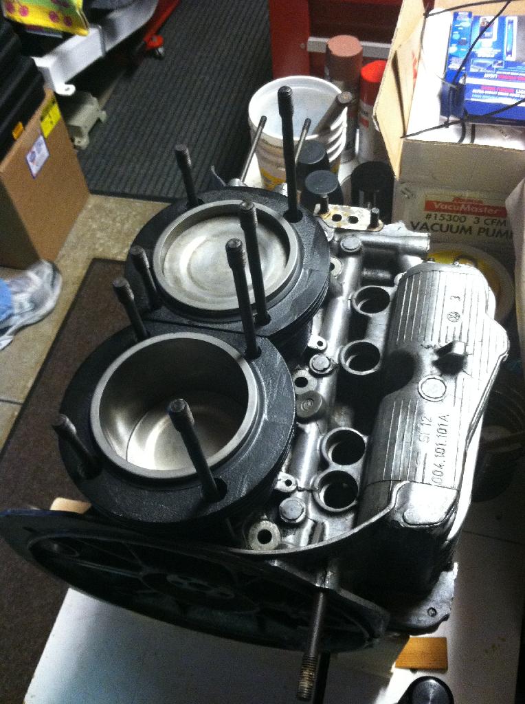

colingreene   Took my motor apart. Its bad news folks. I found a...   Nov 9 2013, 07:05 PM
euro911   A good machine shop can bore stock 94mm (2.0L) Mah...   Nov 9 2013, 08:28 PM
colingreene   Lets just say, im not too worried about the emissi...   Nov 10 2013, 02:04 AM
euro911   Lets just say, im not too worried about the emissi...   Nov 10 2013, 08:16 AM

colingreene   Third try now. If the KS stock Cyls are good qual...   Nov 10 2013, 04:39 PM
Kirmizi   Bumper back-dating instructions right here: :D h...   Nov 10 2013, 08:03 PM
Dave_Darling   Going to a 78mm crank is a more complicated thing ...   Nov 10 2013, 08:40 PM
colingreene   Ah, so much for that. If its dealing with a reduce...   Nov 10 2013, 10:03 PM
