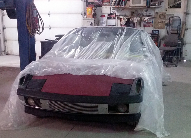

Today started pretty out good. I installed the stainless tunnel fuel line in that I've had sitting around for "a while." I picked this up in a group buy I thought was a couple years ago. Then I open the box and found the invoice inside: 2006 (IMG:style_emoticons/default/unsure.gif) (IMG:style_emoticons/default/laugh.gif) Ooops. Guess I've had it for a little longer than I thought. Oh well, can't rush greatness, right? (IMG:style_emoticons/default/av-943.gif)
Then, using the 2003 350Z billet grille I snagged on ebay for $34, we modified and mocked up the bumper. SWEEEEET!!! (IMG:style_emoticons/default/aktion035.gif)
Steve's going to see what his plating guy will charge to fill the tit holes and re-chrome the bumper. The bolt head there is just so we could get a feel for the shape and size, and DAMN does that look better than the open hole I've gone with for the last 10 years or so. Thanks for the tip to Andys. (IMG:style_emoticons/default/beerchug.gif) Steve's chrome guy does plastic too, so I will have the fog grilles re-plated as well.
