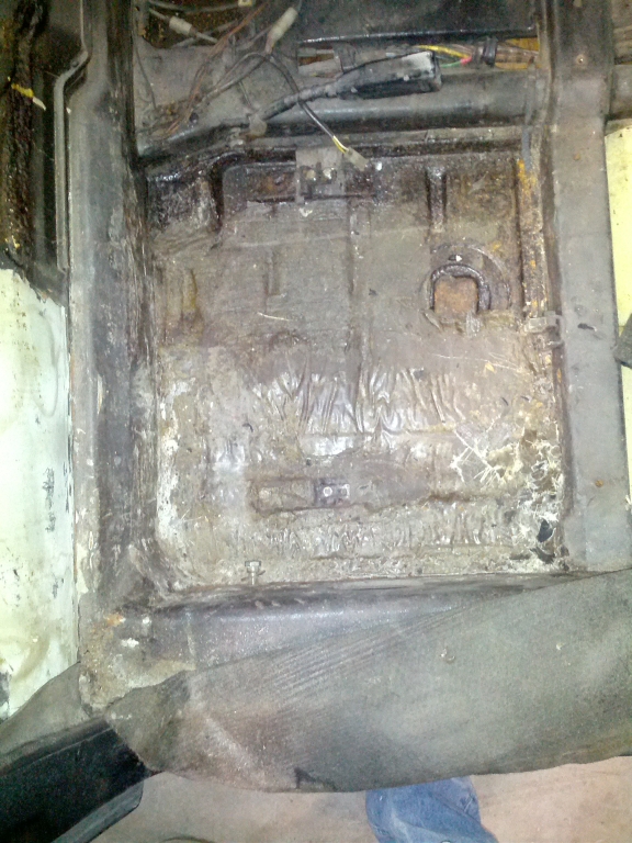

Then, things went a bit south. I was pulling the interior because I am going to treat some rust in my tunnel, and since I got new carpet for christmas, it had to come out any way. That's when I found this:
Son of a . . . . . Fiberglass. (IMG:style_emoticons/default/headbang.gif)

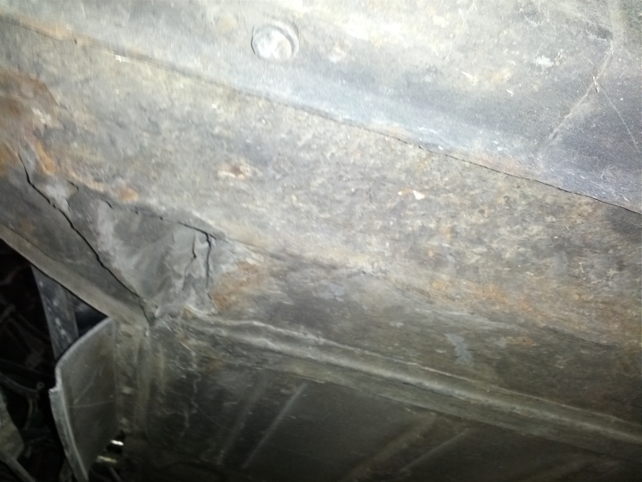

Gotta be honest, I'm a little pissed. Way back when, I flew out to Georgia to look at the car, I crawled under it and saw this:
I asked the PO what was going on there, and he told me it was just basically a cavity cover part of the floor pan, and it was the only sheet metal issue anywhere on the pan. I thought, "well, its not structure, and I don't see any other issue with the pan" and I couldn't examine the interior side because he had glued sound proofing to the entire interior floor. The rest of the pan does look solid as a rock from the bottom, and the entire area around the suspension ear is a 9/10. So I took his word for the "no other issues" part.
I know, I know, "buyer beware", and I was no 914 newbie either, but what hacks me off is he HAD to know about it even if he didn't do it, because HE glued the soundproofing to it. So he not only knew about it, but he knew I couldn't see this fiberglass bullshit without pulling up the glued down carpet and soundproofing that was covering it. (IMG:style_emoticons/default/bs.gif)

aircooledboy   Then, things went a bit south. I was pulling the i...   Mar 1 2014, 04:37 PM
aircooledboy   So, what do you guys think? How bad is that, and w...   Mar 1 2014, 04:39 PM
Chris H.   That sucks man. Very disappointing. So it's ...   Mar 1 2014, 06:39 PM
r_towle   Buy a rear 1/4 pan, once you see it, you will what...   Mar 1 2014, 06:47 PM
rick 918-S   Could need to do this.... :unsure: http://www.91...   Mar 1 2014, 09:41 PM
aircooledboy   I'm gonna see if I can get out there today and...   Mar 2 2014, 09:23 AM
Chris H.   If the long is OK then you're probably right. ...   Mar 2 2014, 11:37 AM
aircooledboy   Yeah Baaaby :monkeydance: It is in deed just a fl...   Mar 2 2014, 06:32 PM
