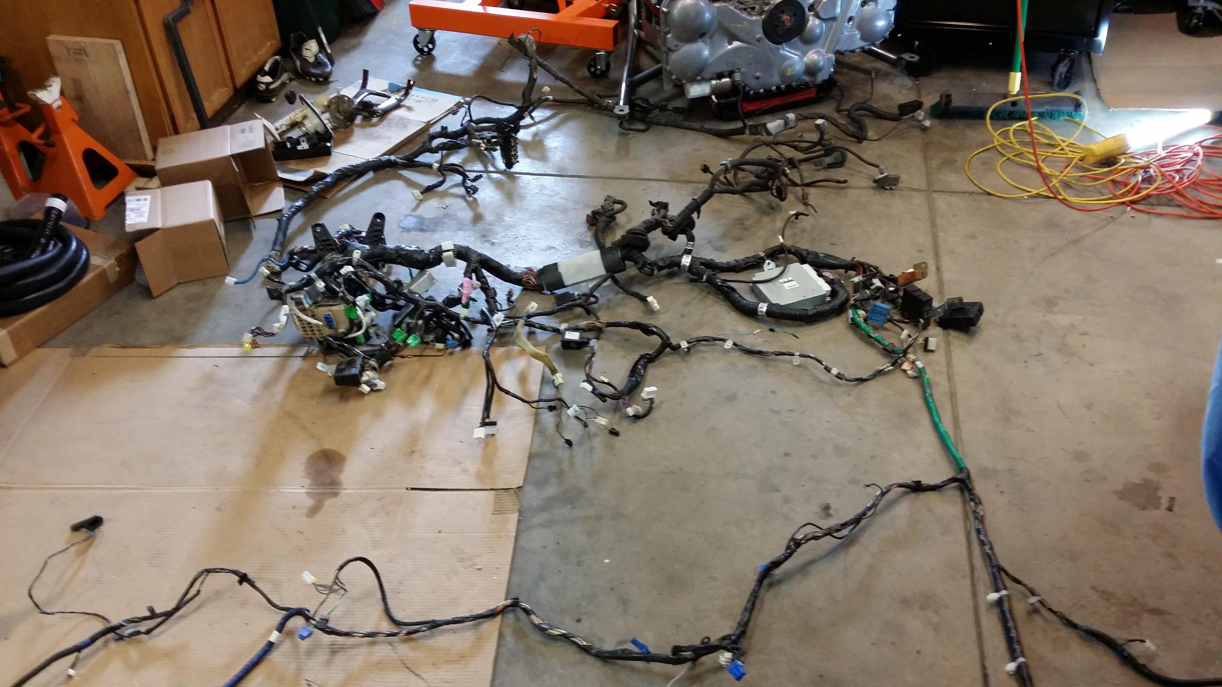

I got a bit distracted last week while hanging out with a friend in his garage! It's enough to make anyone jealous!!
I got back to it this weekend. I spent close to 6 hours outside in 15 degree temperatures and snow pulling the wiring harness or of the donor car! I had no idea how much work that was going to be.
I shop potent last night adding flags to the connectors on the harness preparing to start cutting.
Before I do, are there any systems that seem like they should get cut but are essential?

76-914   I don't envy you sorting that maze out! Yo...   Mar 3 2014, 09:25 AM
rnellums   I finally got every connector flagged according to...   Mar 3 2014, 10:50 PM
76-914   Ross, is the pump controller in there? Shit, I jus...   Mar 3 2014, 11:37 PM
rnellums   Where would it have been in the car? I pulled the ...   Mar 3 2014, 11:38 PM
