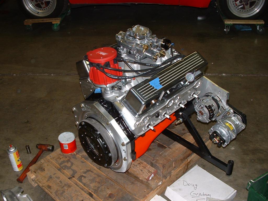

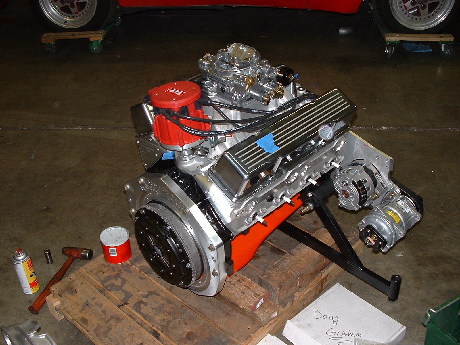

The compressor that came on dealer installed A/C systems was a York Piston style compressor that had a capacity of 6 cubic inches/Rev. From what I could find it used about 7-10 horsepower from the engine. You can still use this compressor however there are better, more efficient options out there. When choosing a new compressor it is a good idea to find one with a similar capacity. In this case going bigger does not mean better. An A/C system works as a whole unit and if you dramatically change one aspect of it, you will likely see negatives effects elsewhere. Choosing a compressor that’s too big will overwork the system, yielding no little to no benefit, and create a not-as-efficient system. During my search I looked mostly at Sanden style compressors so that's what I'll be referring to in my build. Using a modern compressor like the Sanden will only use about 3-4 hp from the engine. I have heard quite a few people use the Sanden 508 compressor with good results. It has an approximate displacement of 8 cubic inches/rev, which IMO is slightly more than I'd like to make a jump to. I'm not saying it wouldn't work, it obviously works, however I think I will get slightly better results and pressures using the Sanden 507 (approx. 7 cubic inches/rev). The SD507 is also slightly smaller in size than the 508.
Here is a picture of the York Compressor
A side by side with the SD507
And here is a SD508
