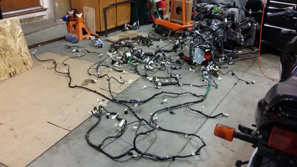

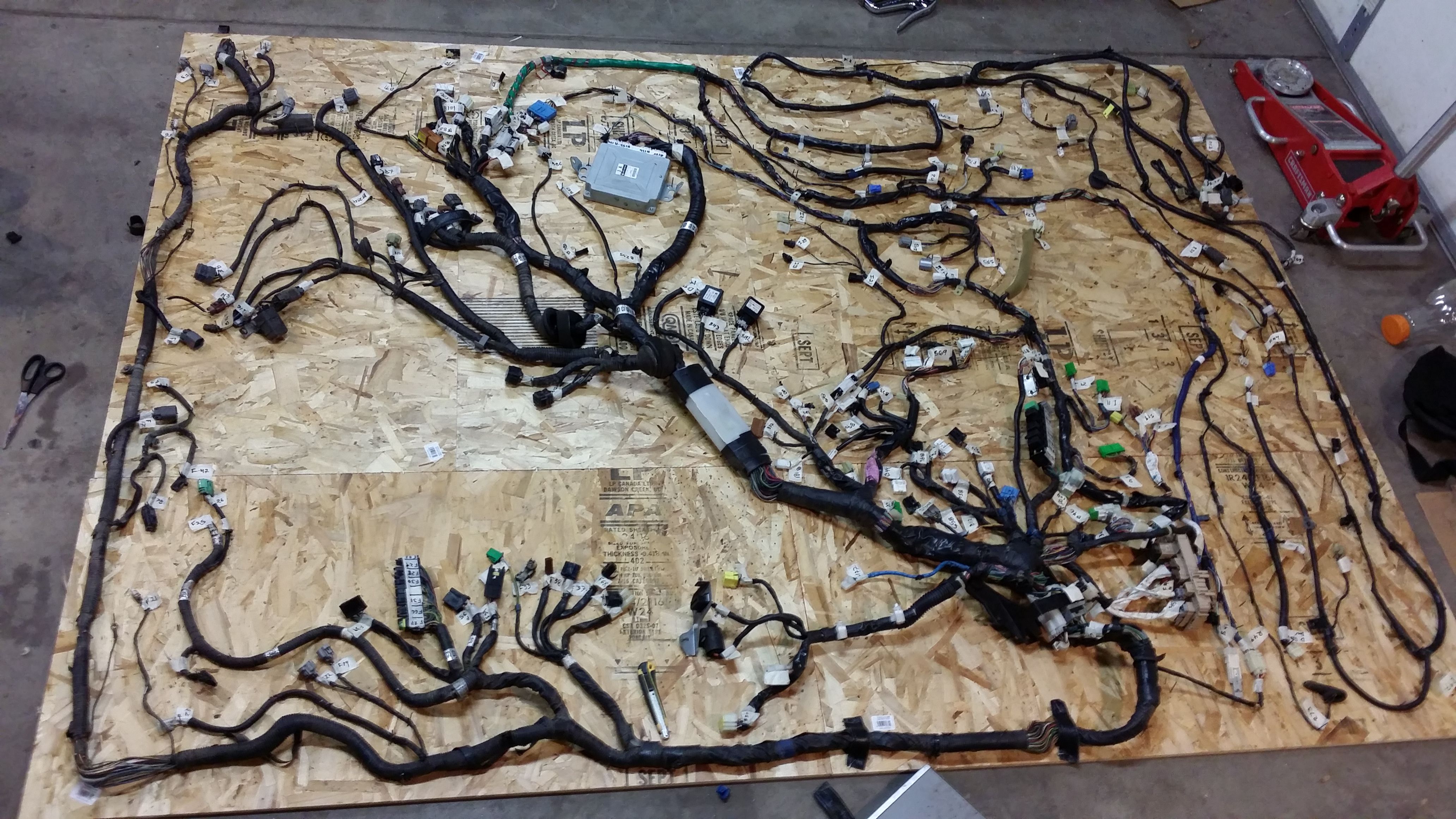

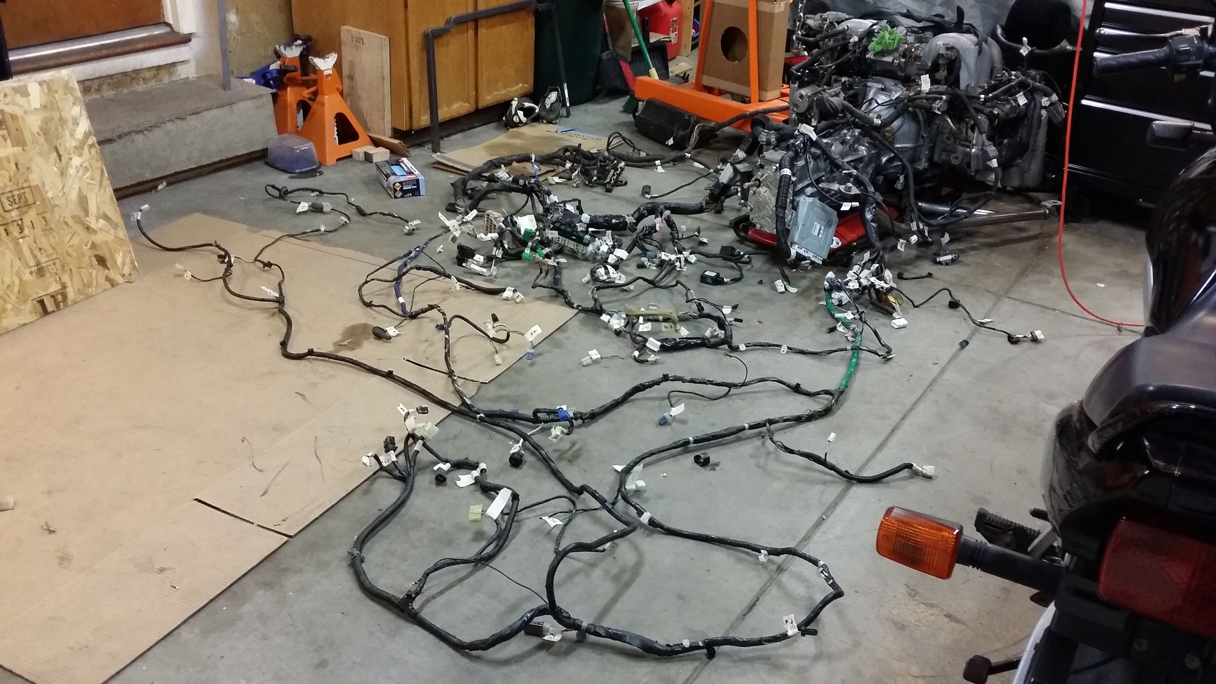

I finally got every connector flagged according to the manual tonight (manual downloaded from this sweet source: http://jdmfsm.info/Auto/Japan/Subaru/).
Then I spent a few hours carefully nailing it to a piece of plywood to keep things organized when I start to cut!
It was a ton of work on the front end, but pretty much everything should go smoothly from here out (I hope).
