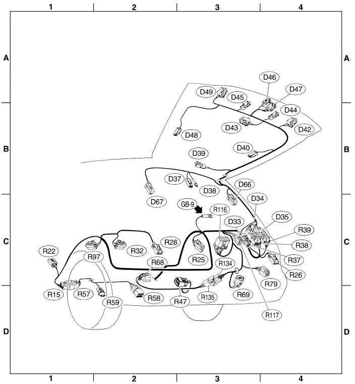

76-914   Ross, is the pump controller in there? Shit, I jus...   Mar 3 2014, 11:37 PM
rnellums   Where would it have been in the car? I pulled the ...   Mar 3 2014, 11:38 PM
904svo   The fuel pump controller is located in the trunk, ...   Mar 4 2014, 08:18 AM
rnellums   The fuel pump controller is located in the trunk,...   Mar 4 2014, 08:47 AM

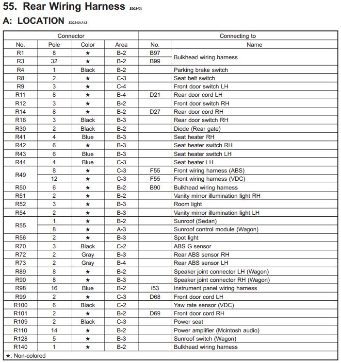

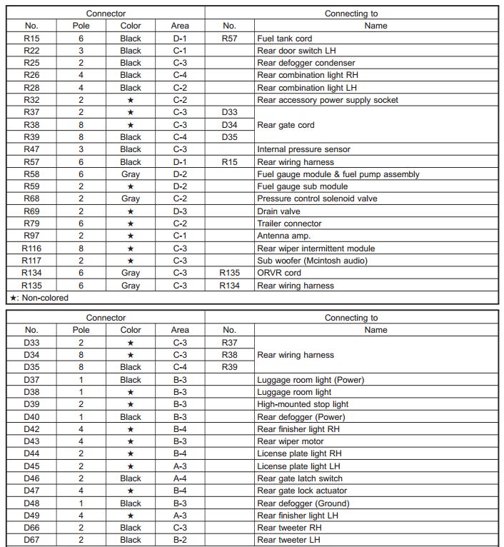

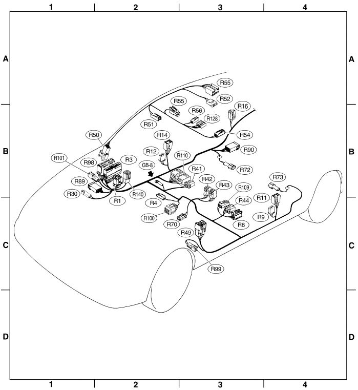

scotty b   Also if it helps you or anyone else, I have factor...   Mar 4 2014, 09:13 AM
76-914   That looks like the sch from an Outback. If so it ...   Mar 4 2014, 09:47 AM
rnellums   That looks like the sch from an Outback. If so it...   Mar 4 2014, 11:47 AM
76-914   That looks like the sch from an Outback. If so i...   Mar 4 2014, 05:19 PM
rnellums   My mistake. I saw the hatchback lid and.....duh. ...   Mar 4 2014, 10:43 PM
76-914   My mistake. I saw the hatchback lid and.....duh....   Mar 5 2014, 05:32 PM
