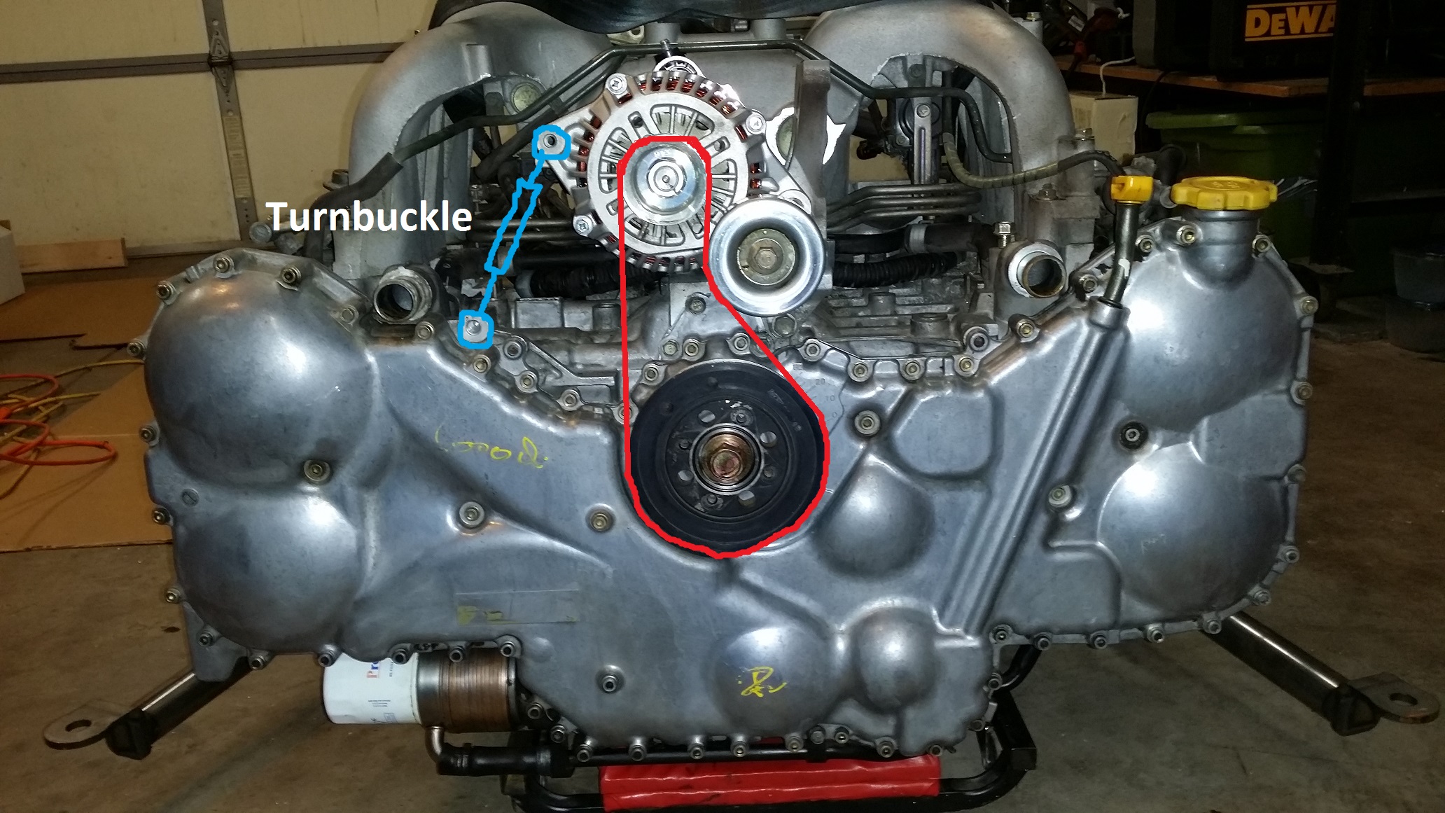

I'm laying my plan out for the accessory belts. I don't plan to run A/C, and I have no need to run the power steering pump, so I plan to remove those from the system. The idea is to attach the alternator on the swinging end to a turnbuckle type strut connecting it to the engine case, and using the alternator itself as the tensioner, much like the layout on the 914. I've drawn my anticipated layout on this image.
Anyone see anything that looks absolutely terrible?

QUOTE(rnellums @ Feb 21 2014, 10:01 PM) *
source the turnbuckle from a 944 r 928. they used that setup for the belt tensioning Very simple, and very effective (IMG:style_emoticons/default/smile.gif)

QUOTE(scotty b @ Mar 4 2014, 07:09 AM) *
Has anyone found a wiring schematic as to what is and is NOT needed for our conversions ? That is the part of this I really dread doing. I hate wiring (IMG:style_emoticons/default/mad.gif)
For an 3.0 or 3.3?
