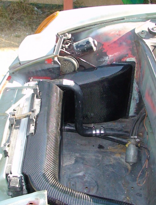

On the radiator setup, you might want to look at PJ Haun's website if you want to put it in the floor.
PJ Haun's Site
Definitely want the fan to pull the air through the radiator, not push it as Stephen said. PJ has a fan under the rad and a lip to a create low pressure area.
I was dead set on doing mine that way til I saw Mike (Ruby914)'s setup.
He put the radiator a lot closer to the front of the car than most and then made that awesome carbon fiber ducting. Could be done in fiberglass too, which I might try.
