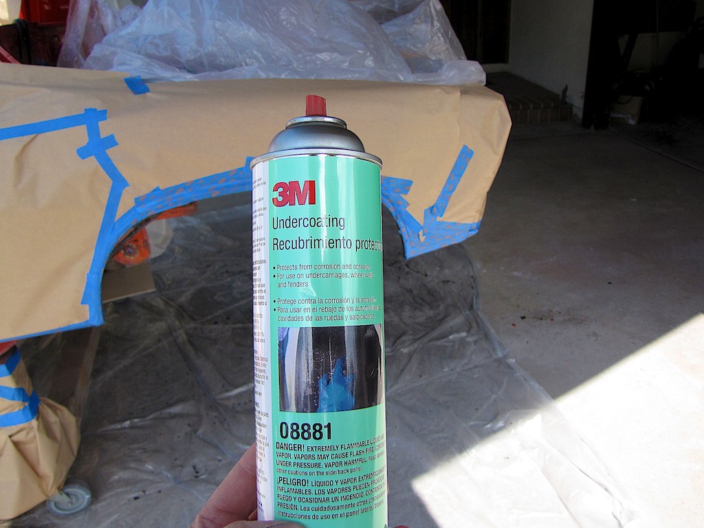

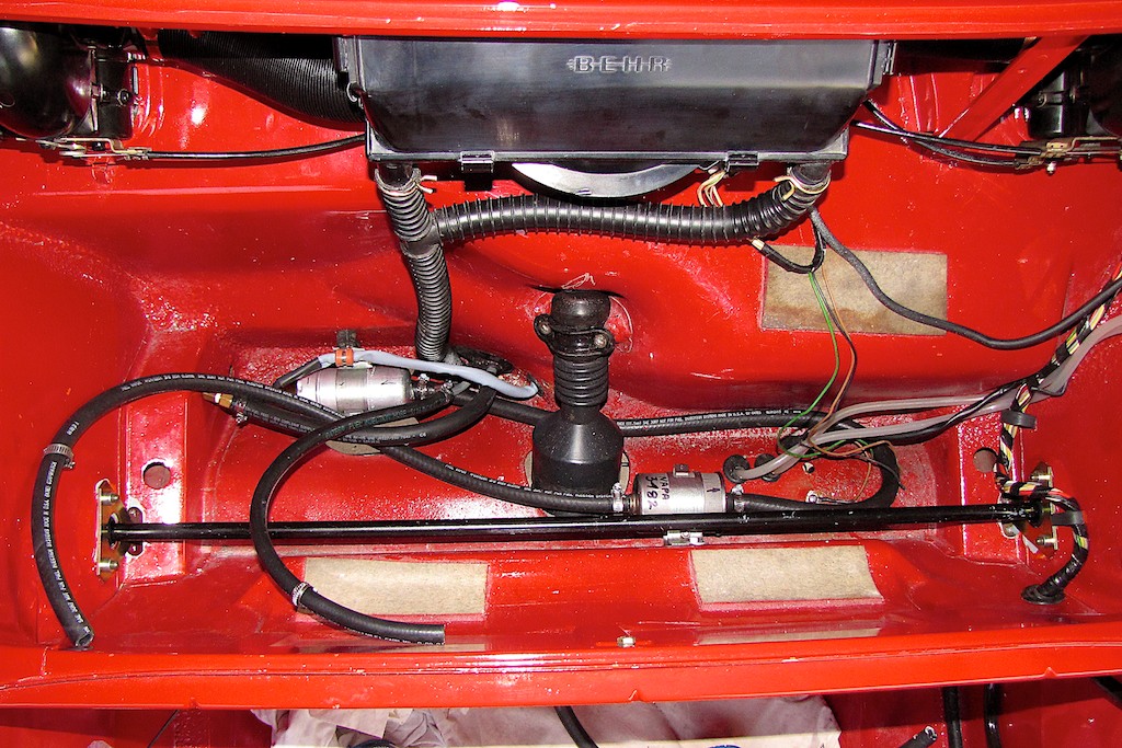

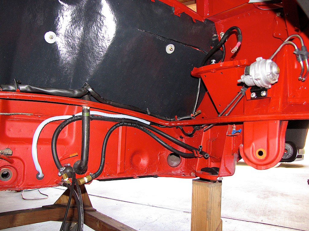

Applied undercoating and relocated the fuel pump and filter to under the gas tank.
The pump I used is a NAPA Bosch N69133 and the filter is a NAPA 3482. For the fuel lines I used 3/8 & 5/16 steel lines from NAPA. I cut them to length and flared the ends for the fittings. I did buy stainless lines to connect to the engine.

QUOTE(Steve_R @ Mar 4 2014, 06:17 PM) *
... and relocated the fuel pump and filter to under the gas tank.
totally awesome work! Won't the filter location make it really hard to change?
Steve_R
post Mar 5 2014, 08:07 AM
Posts: 68
Joined: 8-August 12
From: San Diego, CA
Member No.: 14,777
QUOTE(type47 @ Mar 5 2014, 04:18 AM) *
Thanks and good point. I think I'll re-relocate it back to it's original location and maybe add some insulation to help with vapor lock.

QUOTE(Steve_R @ Mar 5 2014, 06:07 AM) *
Actually, now that I think about it, it should be between the tank and the pump.
So, I think I'll just leave it there. I want it to look stock as much as possible so I don't want to put it in the front trunk.
