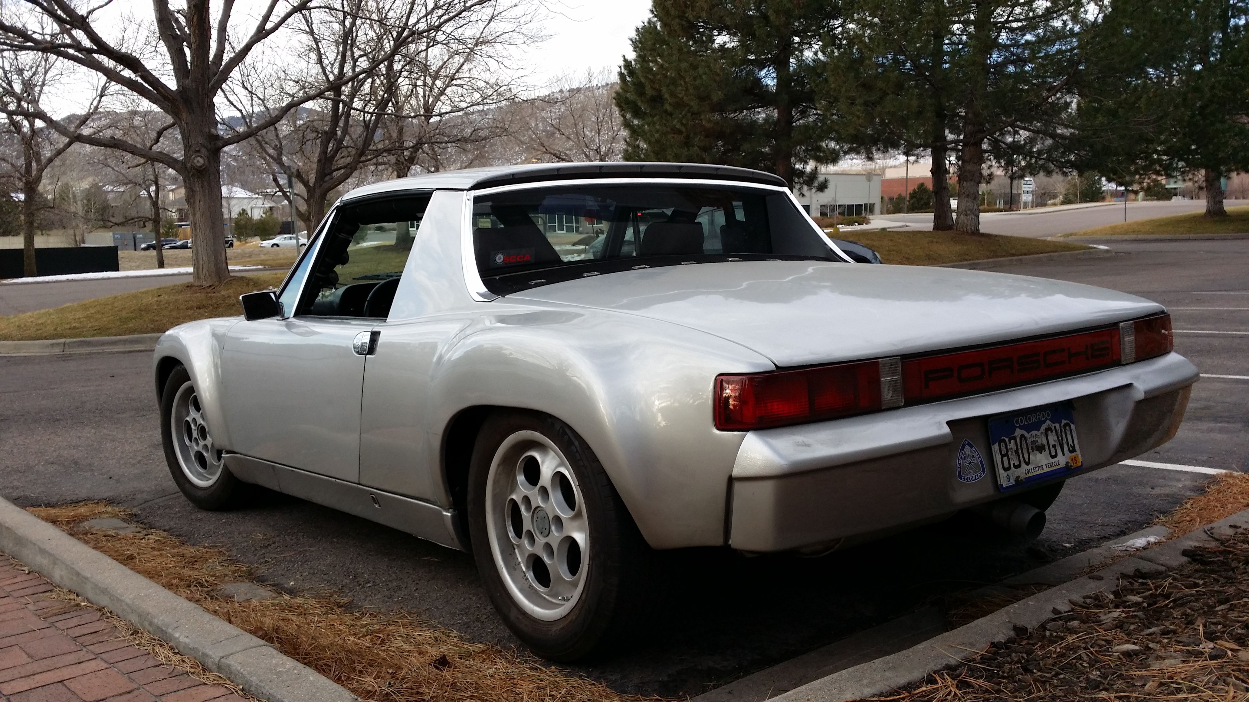

I am starting this thread to document the build of my recent acquisition of a car I am going to name Apollo. It was previously owned by a fellow out in Illinois and was sold to me via 914 LTD. From what I know It was a purpose built Auto X car, but only has about two hours of run time on the engine.
Here are the specs as I received it:
Exterior Mods:
  • Factory Steel Flares
  • Newish Silver Base/Clear
  • Fiberglass 916 Style Front Bumper
  • Fiberglass Stock Style Rear Bumper
  • Fiberglass Hood With Headlight Delete
  • Fiberglass Trunk
  • Fiberglass Painted Rocker Panels
  • Painted Targa Top
  • Lexan Rear Window
  • Lightened Door Skins
  • Original Doors, Hood, Trunk
  • No Wipers, Headlights
  • Rear Porsche Reflector
Interior Mods:
  • Koenig Race Seats
  • RaceTech Leather Wheel
  • Amco Console with Assorted Gauges
  • Welt. Short Shift Kit
  • Bolt in Cage with Door Bars
  • Simpson 4 pt. Harnesses
Suspension Mods:
  • Rich Johnson 5-Lug Conversion
  • Front Volvo Big Brakes
  • Front Vented Rotors
  • 911 Front Struts
  • Koni Adjustable Shocks
  • 914-6 Rear Rotors With Stock Front Calipers
  • 22mm Front Torsion Bars
  • Welt. Adj. Front Sway
  • 180 lb Springs w/Adjustable Perches
  • Hoosier Road Race Radials
Engine Specifications:
  • Front Mounted Oil Cooler
  • 2.4 L 4-cyl built by ROCS auto
  • 103mm J+E Forged Pistons
  • 1.8L Stroked to 2.0 Specs
  • 48mm Intake
  • 38mm Exhaust
  • Chromoly Pushrods
  • High Flow Oil Pump
  • MSD Ignition w/ Adj. Rev. Limiter
  • 44mm Dual Webers
  • Lightened Flywheel
  • Kennedy Engineering Stage IV Clutch
  • Ported, Polished Heads with 10:1 Compression
  • Port Matched Manifolds
  • Kerry Hunter Headers
  • Claimed 180 HP
  • Claimed 170 ft-lbf Torque
Transmission Specs:
  • Recent Rebuild by 914 LTD
  • Quaffe Torque Bias Diff
  • Shortened 5th Gear
Misc:
  • 5 Gal Fuel Cell
  • New Bearings and Bushings
  • Blue Brake Fluid
  • 8x15 Fuchs
  • Claimed 1600 lb Weight
And Now the pictures!
