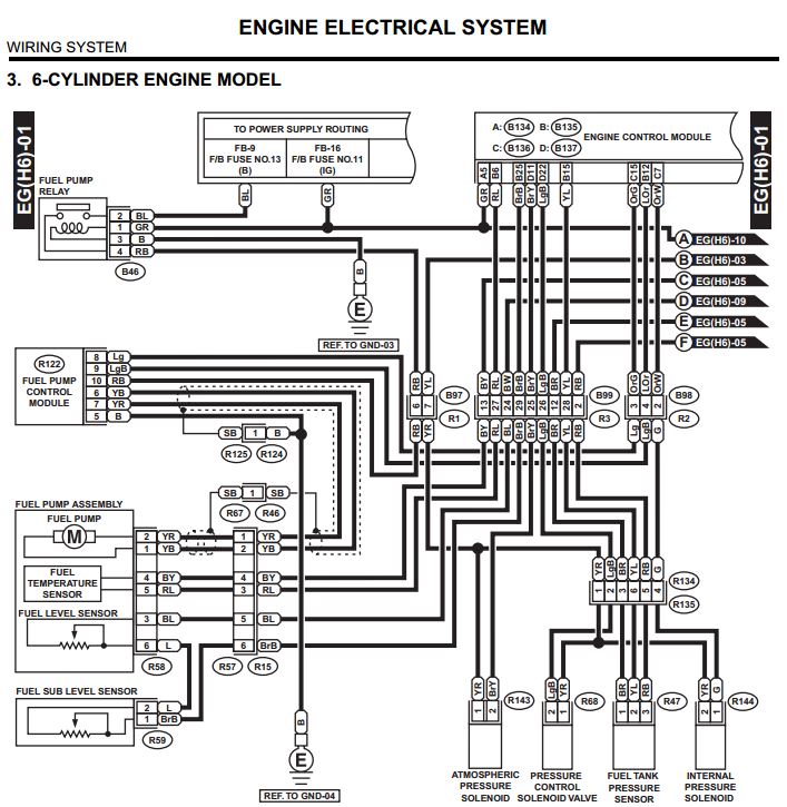

In your factory manual; is there a page in the wiring sch's section that reads "Fuel System" or Fuel Pump" at the top of the page? Should be 2 of them. One for the 6 and one for the 4 cyl. Also, Look for two yellow wires. One with a blk stripe and one with a red stripe. Those are the + & - to the fuel pump. Maybe work backwards from there. Do you still have the car available to you? If so, can you shoot some pic's?
rnellums
post Mar 6 2014, 10:12 AM
Professional Enthusiast
Posts: 1,673
Joined: 26-November 09
From: Littleton, CO
Member No.: 11,072
QUOTE(76-914 @ Mar 6 2014, 08:11 AM) *
No access to the car I am afraid. The closest thing to fuel system is "fuel gauge", but still no controller.
In the 2001 engine wiring harness it shows more connections to the fuel pump, but they all go to the ECU or the fuel pump relay, which is controlled by the ECU as well.
2001 Schematic

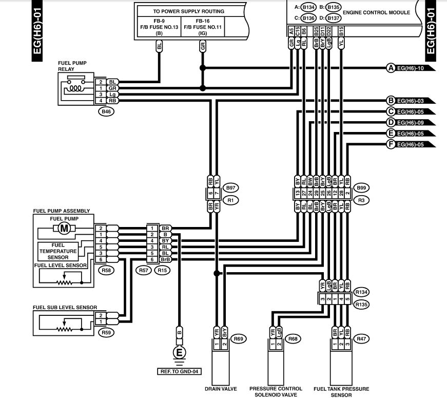

In the schematic I have for the 2003 model, it does indeed show a fuel pump control module. I'm thinking maybe I don't need it after all?
2003 Schematic
