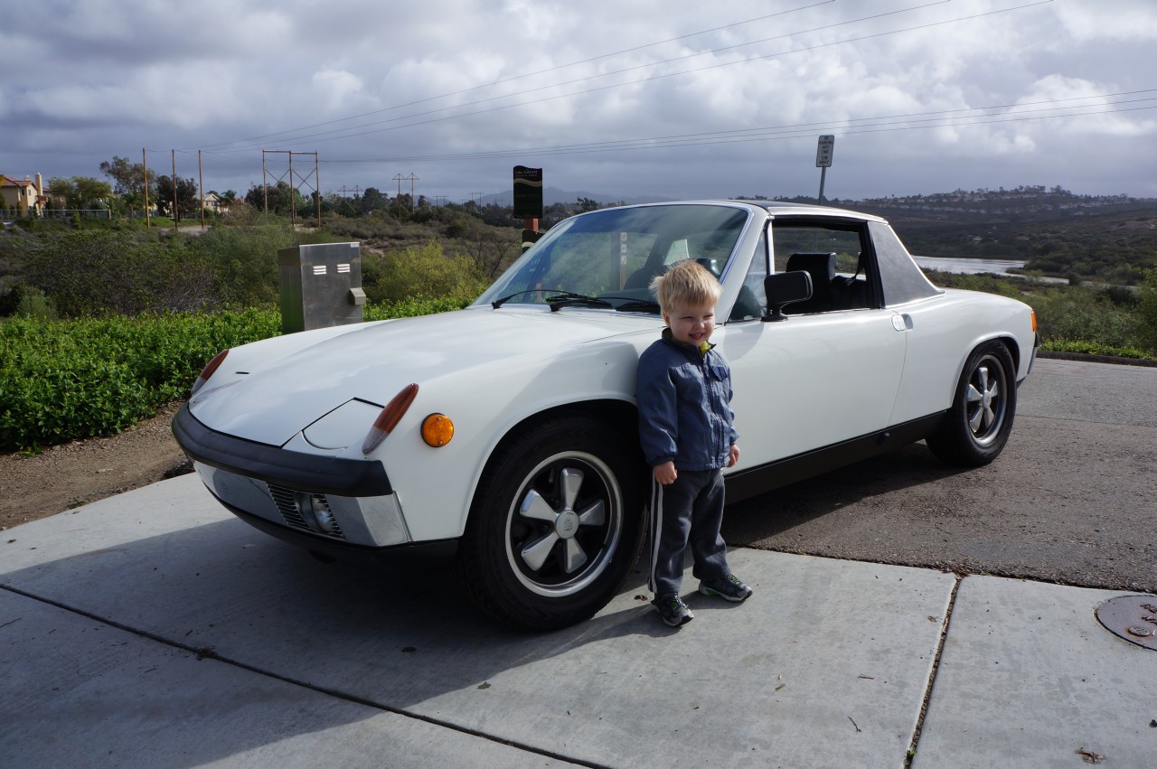

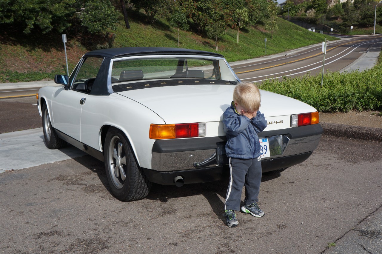

(UPDATED with comments below)
From the photos, this is what I see that is not correct. Anything I'm missing?
Not correct / things to fix:
- outside mirror
- speaker boxes
- after market front air dam
- 80s radio
- white valve covers
- rust (?) spots on carpet
- painted (?) headlight motors
- 4-cyl center console
- color change back to Irish Green
- wheel center caps need to be anodized or something
- incorrect jack
- black plastic threshold plates and carpet cleat should be aluminum
Not right but no reason to "correct" (IMO):
- Euro lenses
- Euro driving lights vs USA fog lights
- 15x6 Fuchs (was originally steel)
May or may not be correct:
- horn button is not correct
- center seat fabric should be smooth (Center cushion could be the Colgan aftermarket item, period correct)
questions / not sure:
- antenna may not be right... ?
- repro rear trunk carpet (missing grommet). or might be orig.
-Steve

Jaymann   Looks fun:I would drive it!!   Aug 22 2013, 10:11 PM
gms   questions: no center dash vent & no dash vent...   Aug 22 2013, 10:21 PM
Jeff Bowlsby   Euro driving lights vs USA fog lights Center cushi...   Aug 22 2013, 10:37 PM
Jasfsmith   Repro rear trunk carpet (missing grommet) My ...   Aug 23 2013, 10:49 AM
Eric_Shea   Tool kit doesn't appear to be basket weave...   Aug 23 2013, 06:30 AM
396   I believe a previous asking was 35k for this -6   Aug 23 2013, 12:04 PM
Chris H.   Painted headlight motors!? RUN AWAY... :barf...   Aug 23 2013, 12:16 PM
siverson   Thanks for the feedback. I updated the first post.   Aug 23 2013, 05:31 PM
JmuRiz   It's just what happens with years of owners cu...   Aug 23 2013, 05:52 PM
lostreasure   Gas tank area is suppose to be painted body color....   Aug 23 2013, 07:12 PM
Gustl   From the photos, this is what I see that is not c...   Aug 24 2013, 11:39 AM
