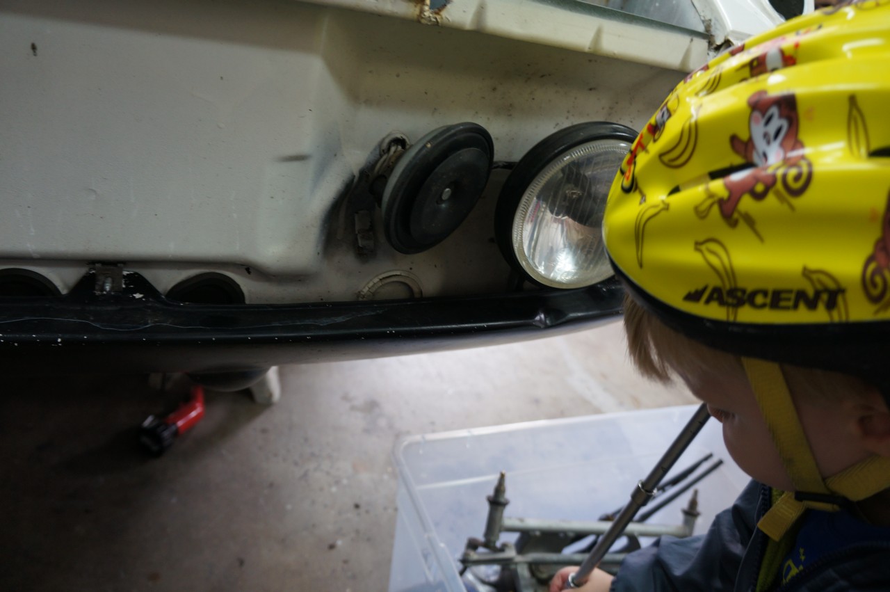

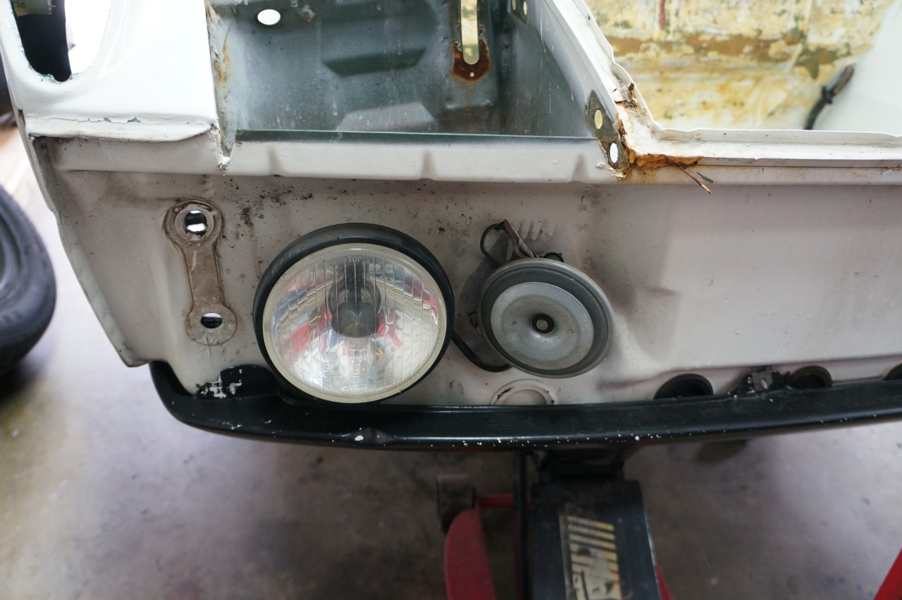

siverson   White, green, and black (spray paint! argh...   Mar 7 2014, 10:11 PM
siverson   One spray painted horn, one not. And... are these ...   Mar 7 2014, 10:13 PM

siverson   Nice... I'm pretty sure these are the original...   Mar 7 2014, 10:20 PM
