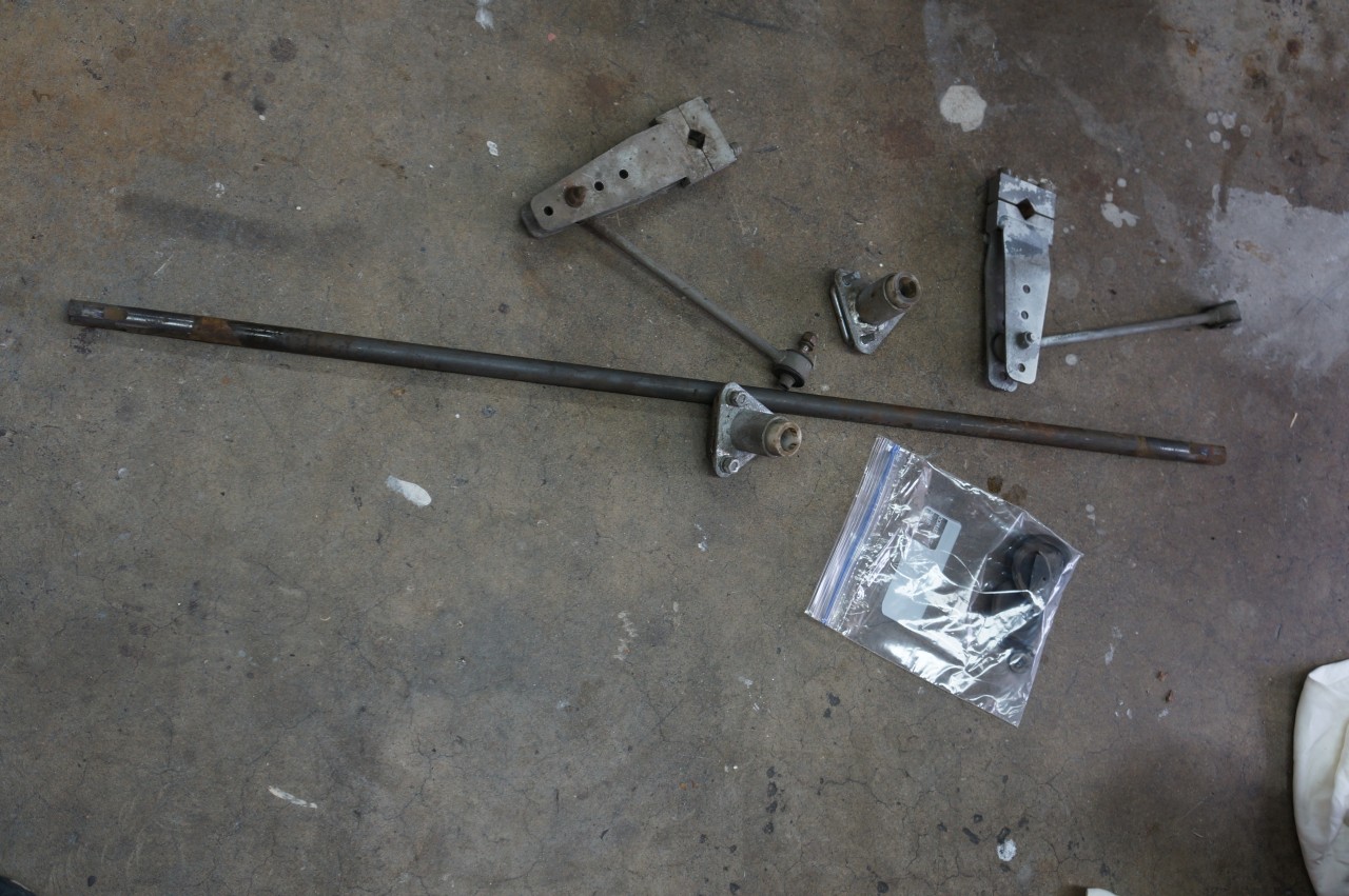

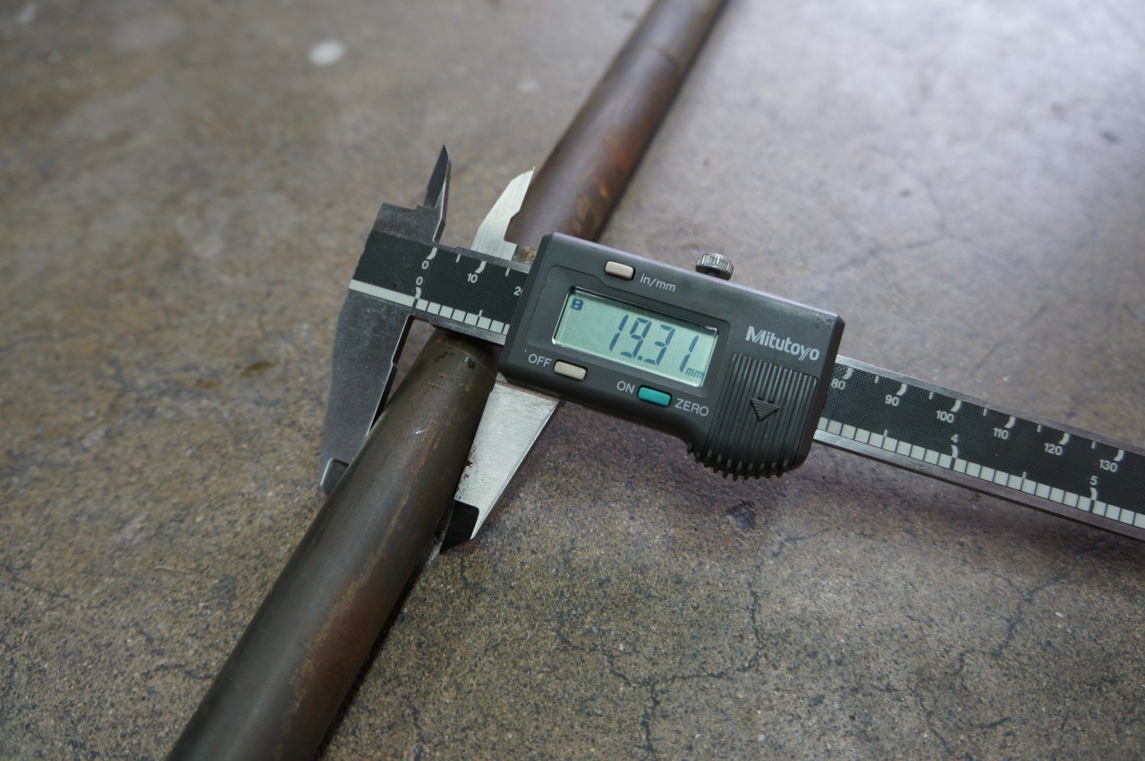

From: San Diego, CA
Member No.: 654
Removed old aftermarket sway bar. Anyone know what brand it is? Quality actually seems pretty decent...
-Steve
