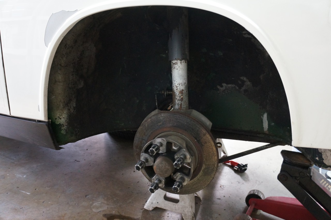

siverson
post Mar 7 2014, 10:17 PM
Posts: 2,464
Joined: 5-May 03
From: San Diego, CA
Member No.: 654
Green, white overspray, and original 914-6 grey struts peeking through...
-Steve
